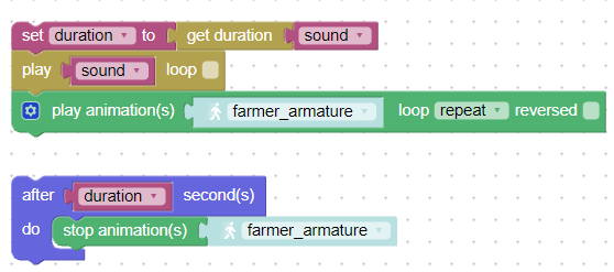

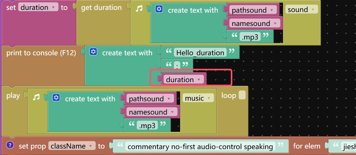

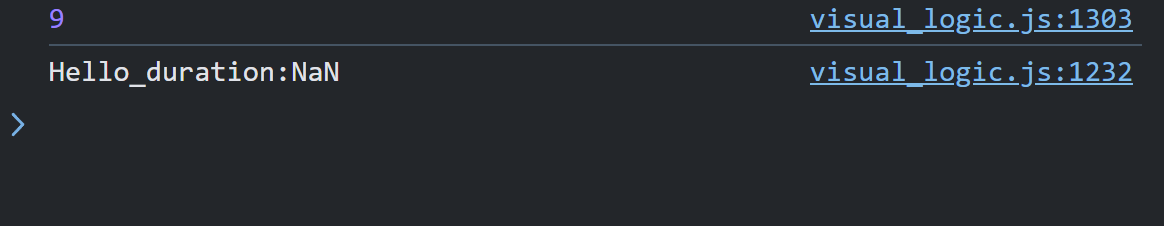

    HI KDV:
    Using get duration sound is indeed another solution, but it has a drawback that when the audio is not playing, it is impossible to obtain the audio duration in advance. The console prints NaN, but if the audio is played once, it is indeed effective.Please take a look at the puzzle below:
    yes, it won’t work this way. Your sound should be loaded beforehand to read its duration.

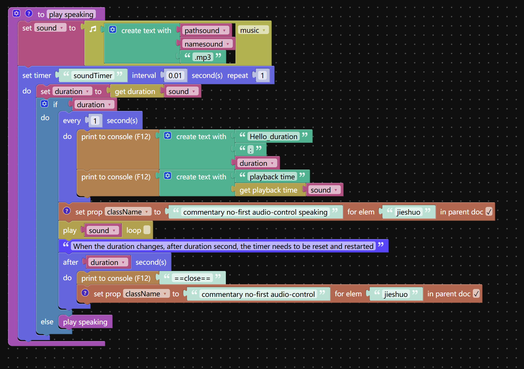

    HI KDV:I have seen your YouTube reply video. Thank you for your reply. My audio path and audio name are both variable concatenation, and the read audio file is also uncertain because it is not one audio, but many. So we cannot load all the audio as you demonstrated, and we need to determine which audio duration it is. If we add the ended feature in the new version, it will simplify many steps and increase the amount of code. My puzzle is as follows:
    but you didn’t see the point (the procedure is repeated until it gets a sound’s duration and only after that the sound will be started. it will take max 0.1 sec). and no, your puzzles won’t work as you wish.
    You now have three options: think and use logic to create a universal procedure to play your sounds (everything you need is in that example); hire somebody to do the job; wait for the grass to grow.
    Improved variant of puzzles. Logic is really simple.
    https://youtu.be/nQyCq4eEzqQ

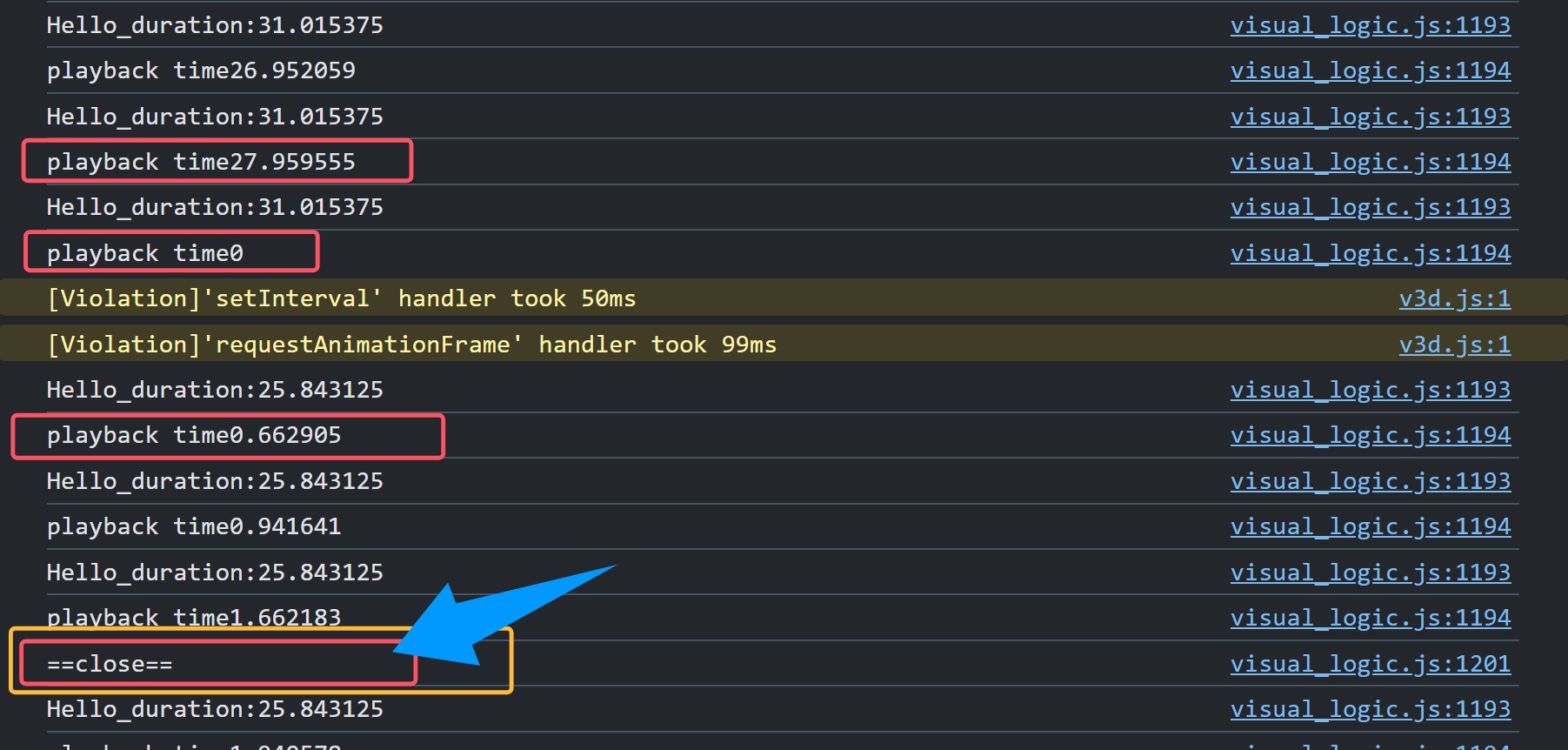

    HI KDV:Thank you for your patient reply. I have carefully reviewed your puzzle and implemented it in my project, but there is one issue that prevents me from achieving the final goal. If an audio is reloaded and replaced during playback, that is, when the duration changes, the after duration second timer needs to be reset and restarted. However, when the after second timer starts, the variable duration inside will not update or change. This means that the lack of an ended feature has led to a series of new issues and an increase in code volume. My puzzle is as follows
    #79074
    Repalce this puzzle by this puzzle
    https://youtu.be/IjT4VnxrBtQ

    the “remove timer” puzzle was not used (it’s not needed). just replace the “after” puzzle with the “set timer” puzzle.
