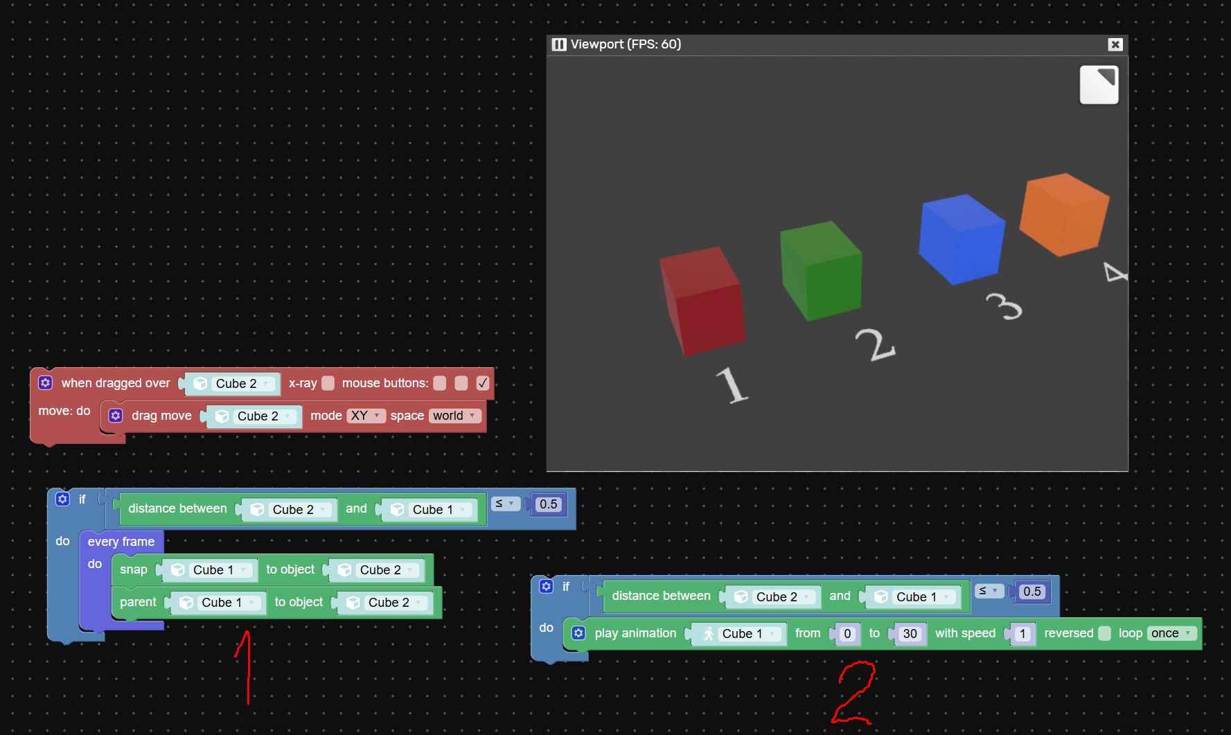

    Guys I am trying to set up the puzzles to affect the “Red cube 1” when “Green cube 2” comes in certain proximity.
    I tried for both parenting & animation trigger of red cube why it snot happening?
    Am I missing anything?

    This is small ref video of what is happening

    The first snippet should work (though the parenting is redundant in such case). Check that these cubes are actually “Cube1” and “Cube2” (use print to console to debug).
    The second snippet won’t work since it’s being executed only once upon application start. But, since the distance between the objects is more than 0.5 it won’t play the animation.

    visualizer
    Actually it should work in first case… but still it is not working.
    The snap didn’t work that’s why I added the parenting. Else its not needed. I agree
    what’s possible? shall I provide blend file?

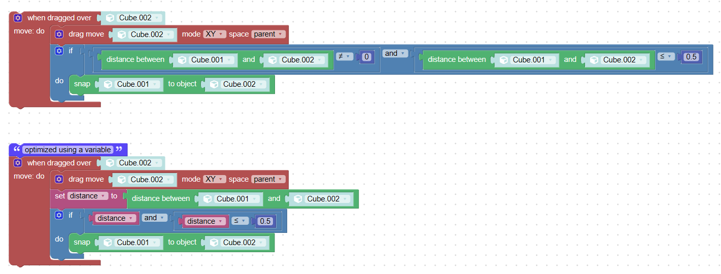

    I see that it is working with your setup prepared but is that needed so lengthy to make it happen? Just curious.
    especially “DIstance” variable inserted & why we need “parent” in drag move puzzle?

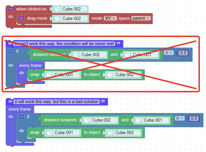

    Actually, it won’t work as expected because the condition will be met only if your cubes are initially close to each other.
    same with the first one.
    I just reproduced your puzzles. I don’t know why you did use parenting :unsure:
    it’s just a small optimization
