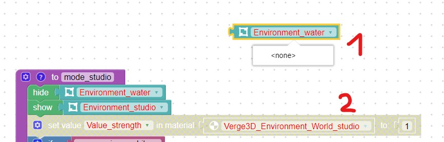

    Hi, I have just updated Verge3D to version 4.1.1. I have a problem with the lightning. When I run the application, the interface made in Webflow looks fine and it works, but the embedded application itself is a plain black screen. The Sneak Peek from Blender looks properly although. Does it have something to do with these other two bugs that I noticed?:
    1. In Puzzles, the selector “Group” puzzle stopped working for Blender. I use it a lot in my application and now, after the update, all of them are red, and the list of choices is totally empty. Puzzles for individual objects and materials work fine.
    2. The World material disappears from the material selector puzzle – it’s not available on the list.
    I removed the “Set value” puzzle for the world material to see if it changes something but unfortunately it is not – the screen is still black.
    Any ideas?

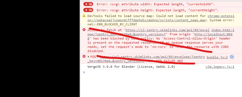

    Hi, what does the browser console display when you load your scene in Puzzles (press F12 and switch to console)?
    #55455
    Mariusz

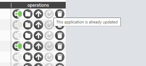

    Hm, nothing special but it seems that it still tries to load the older version of Verge.
    I think the update went well, I can see all the new puzzles. Maybe the issue is in fact, that I cannot click the “update application” button in App Manager? It says “This application is already updated”, so I thought it was made automatically. Should I update it manually somehow?

    Perhaps v3d.js is stored in some non-standard subdirectory. Yep, please update this file manually by copying it from build directory of Verge3D installation (usually located in Program Files).
    Also verify that the engine is really new, by creating a new app and checking the console.
    #55464
    By any chance, aren’t you using the legacy version of Verge3D (v3d.legacy.js). If so, you better switch to regular version (v3d.js), e.g copy as I mentioned above, then modify your app HTML file (find and modify the src attribute in the script tag).

    Mariusz
    Thank you Alexander, it worked!
    I created a new application and copied all the Webflow files, Blender files, and textures, and now it works. Thanks again!
    The v3d.legacy.js file was replaced with v3d.js in the new application.
