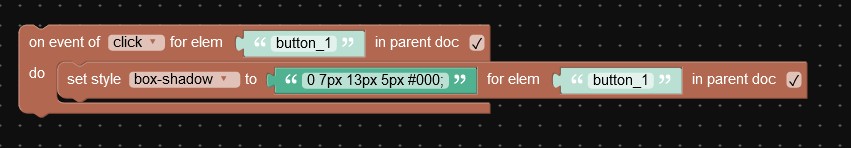

But I dont know how to change the states permanently in puzzles…I also tried to configure the “new state” manually in puzzles.
Example:the button is just a black box. But I want this box to have a box shadow after being pressed. The divs’s ID is: button_1
So I use the set style puzzle set to box-shadow to 0 7px 13px 5px #000; for elem button_1.But nothing changes. What am I doing wrong?
If I set the style display to none for elem button_1 the button disappears. So the ID is correct…Attachments:
2022-05-04 at 7:21 am #51632
Mikhail LuzyaninStaffTry to remove “;” at the end of the text string.
2022-05-04 at 10:51 am #51660
Monokultur-StudioCustomerThat was it! THANK YOU!
