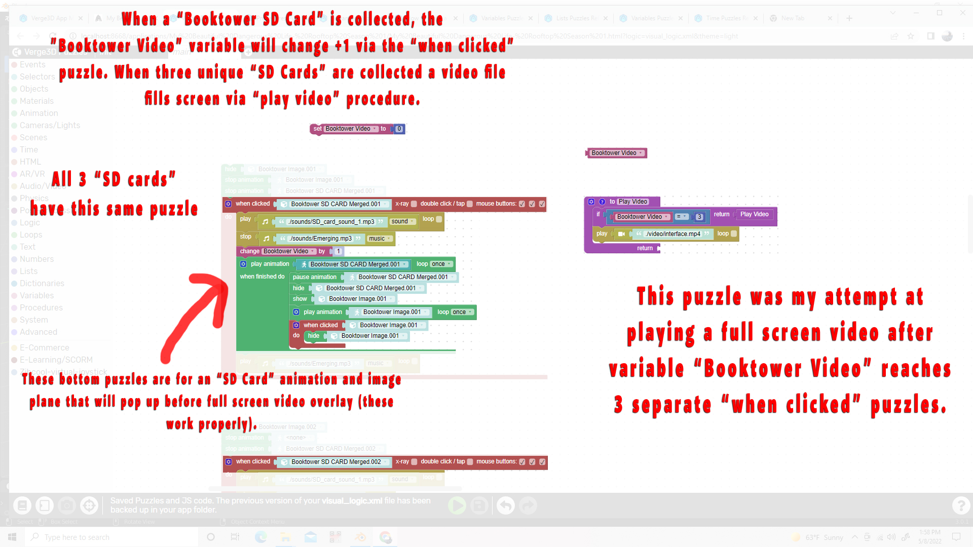

    I am trying to do a full screen video overlay within verge 3d via html video puzzle. But I can’t tell how to make the video play with verge 3d puzzles. Most of the documentation/app template is geared towards if you are applying the video as a texture to an object in the 3d scene, not as a full screen overlay. *Theres an image attached below related to this question and the next one.*
    I am also trying to do something like this with “counter” and “variables/procedure” puzzles- After three unique SD cards are found and clicked by the user, a video is unlocked and it overlays the screen and plays, when its finished playing the user is still in the same spot in the 3d world. *see attached image*

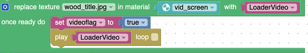

    If you have multiple videos you can do a video replace like shown in the image attached. Otherwise…just load up that video as the main texture for the plane and hide and unhide the plane.
