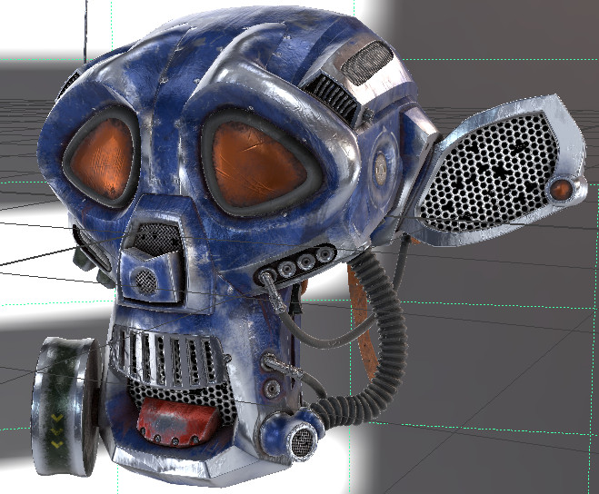

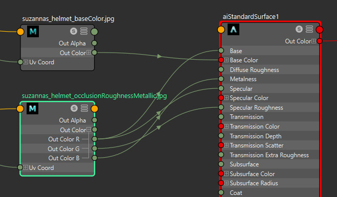

    It is now possible to use 1) occlusion and 2) roughness/metalness textures in the PBR shader. The latter is based on Arnold’s aiStandardSurface shader (prior Maya 2020), or StandardSurface (in Maya 2020). Previously only numeric values were supported.
    These textures can be easily created with specialized software such as Substance Painter. A demo called “PBR” (aka “Darth Suzanne”) has been added to distribution to show out how this works.

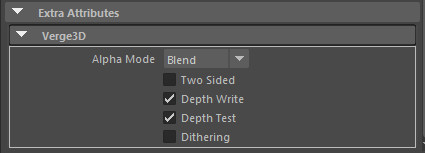

    New material settings are available: Alpha Mode, Two Sized, Depth Write, Depth Test, and Dithering.

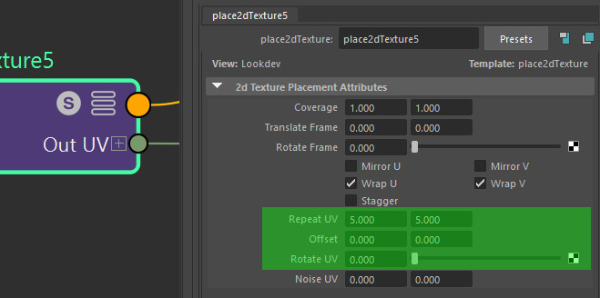

    Texture transforms are now supported including Offset, Rotate UV, and Repeat UV. We used the Repeat UV setting to tweak the material in the Simple Configurator demo.
