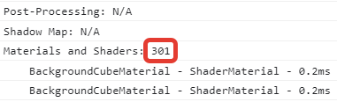

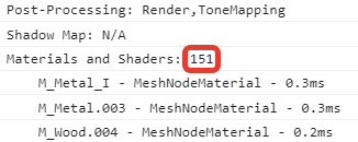

ParticipantAnd what about reflection planes, working with
AA AutoandPP off?Looks like the problem is still here )))
Terrible lags and doubled amount of materials and shaders
AA MSAA16andPP on. Works fine, no lags. Lower FPS on mobile devices.
AA AutoandPP off. Works bad with lags. FPS is higher when it’s not lagging.

Alexander KovelenovStaffAnd what about reflection planes, working with AA Auto and PP off?
It appears the problem is gone and why it’s rendered so slow. Basically, you have 3x times more render calls you have on the other scene which uses MeshStandardMaterial. This is due to 2 additional reflection planes rendered there. To optimize use the Visibility Collection property and place as few reflective objects as possible there.
Regarding shaders, you have the node-based system with many material variations on the first scene and dull, one-size-fits-all gltf-compatible shader on the second. Also, in some cases objects rendered in reflection planes require another shader which can double the total amount.
2022-11-30 at 7:16 am #58688kdv
ParticipantAlso, in some cases objects rendered in reflection planes require another shader which can double the total amount.
but why this doesn’t happen when the post-processing is on? No lags when PP is on. The same geometry, the same node shaders.
they are not even rendered in the begining. they are hidden and
probeClipStartis set to 100. they are not rendered and they see no geometry. and again, no issue when PP is on. They dont’t even affect the frame time value and the amount of tris rendered when PP is on. They are off. I agree to use cubes instedad of planes but they are created and updated tooooo long when PP is off. The main problem is the difference between PP on (smooth, no lags, but slow) and PP off (faster, laggy) when reflection probes are in the scene. No probes – no problem ))) But I need them in that project…Regarding shaders, you have the node-based system with many material variations on the first scene and dull, one-size-fits-all gltf-compatible shader on the second
don’t compare those apps by shaders (I know that they are different, but I made them look identically). Just compare the load time and fps on mobile platforms. It was just an example.
2022-11-30 at 7:42 am #58696kdv
ParticipantTwo examples: no difference in geometry and shaders at all, the scenes are the same. The only difference is in one export option:
Anti-Aliasing MSAA16activates the post-processing, adding two additional passes.Anti-Aliasing Autodoesn’t do it but still provides a good anti-aliasing (preferred).
Works smoothly with two additional PP passes.
https://v3d.net/d1c
Lags and freezes, only one main render pass.
https://v3d.net/cfrPuzzles and JS coding. Fast and expensive.
