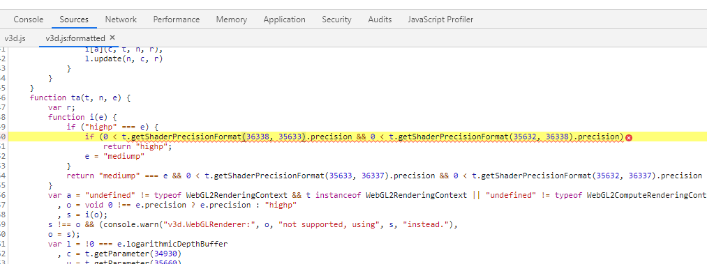

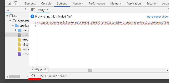

Also, can you show what exactly the error line look like? It may look as follows (I deliberately made an error in that piece of code):

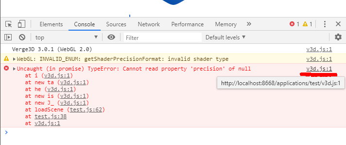

I ran both tests without error. And i attached the exact error as screen shot. It seems to be exactly the same error you created deliberately ??
