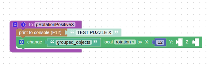

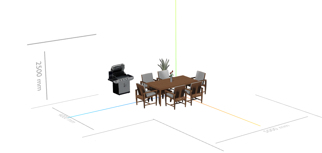

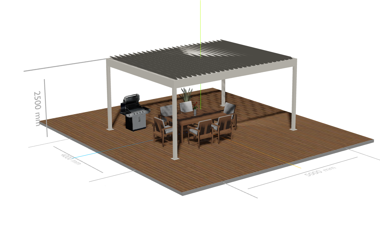

    But the problem is if I make changes to the puzzle (not relevant for the model).
    80% of my model just disappear. (visible in attacments)
    I think it is some problem in sync, I’m I missing some step??
    Would appreciate any help, boka

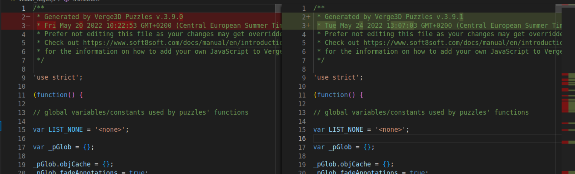

    #52343
    boka5
    Problem ocurr when i change visual_logic.js
    Otherwords, when I save puzzles and it regenerates visual_logic

    Yea, I did it like that also (without overwriting html,js,media) and it is the same.
    All objects/meshes are loaded into the scene. If I search for one, like window.appGlobal.scene.getObjectByName(“<name>”), it gonna find it (visible is settled to true, so it is not hidden).
    Not sure if I did previously something like rename puzzle or something like that, which could cause problems… But couldn’t find any changes relevant regarding the issue.
    Also, if I add a new object/mesh in the blender it appears normally.
