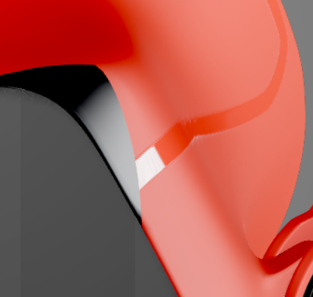

the glass works as expected, but the smooth curved lines on the mask have “fixed” reflections (see hilight spot in the attached image).
I would like to see hilights to move on the surface when rotating the view the same way it happen with the glass.Attachments:

xeonCustomerAfter watching your demo it seems your highlights in your materials other than the glass are “mapped” or baked as textures rather than highlights from sources from either lights or the HDR background.
The problem is not the camera or the background its that the textures for the materials in your scene are not setup in a way they can react to the light in the scene.

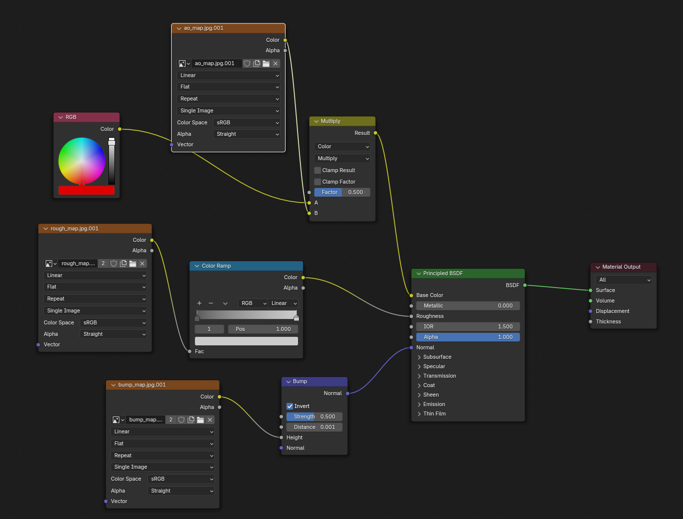

Participantthank you very much.
Can you help me to understand what is wrong in my setup?Attachments:

xeonCustomerI would need the blend file at a minimum, full v3d project with blend file at most.
You can reach me directly at xeons3dlab[at]gmail[dot com]Xeon
Tutorials - https://www.xeons3dlab.com2024-12-18 at 7:55 pm #79460
xeonCustomerFile received. Solution found.
Turns out the camera in the scene was corrupt on some level. I have not figured what the exact issue is or whether it was a setting…Still digging into that but.The solution was to create a new camera … and all is working properly.
Email with fixed blend file has been sent.
Update: the camera in your original file has a “Cycles api script attached” under custom properties for the camera. Removing it doesn’t affect anything but could cause the camera to not function properly in V3D. If you are using a plugin or something that is adding that…try removing or not using it and see if your cameras work properly.
