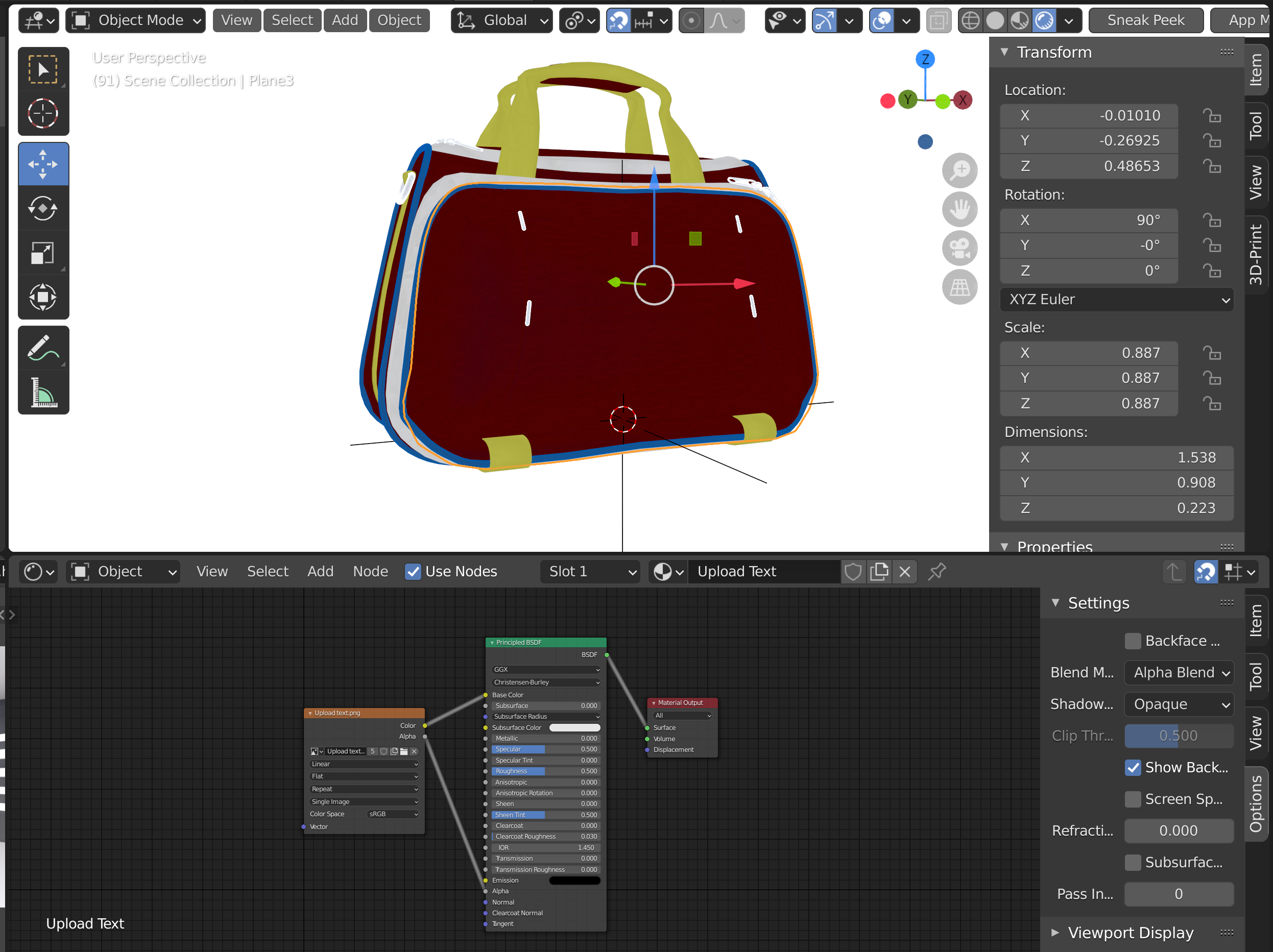

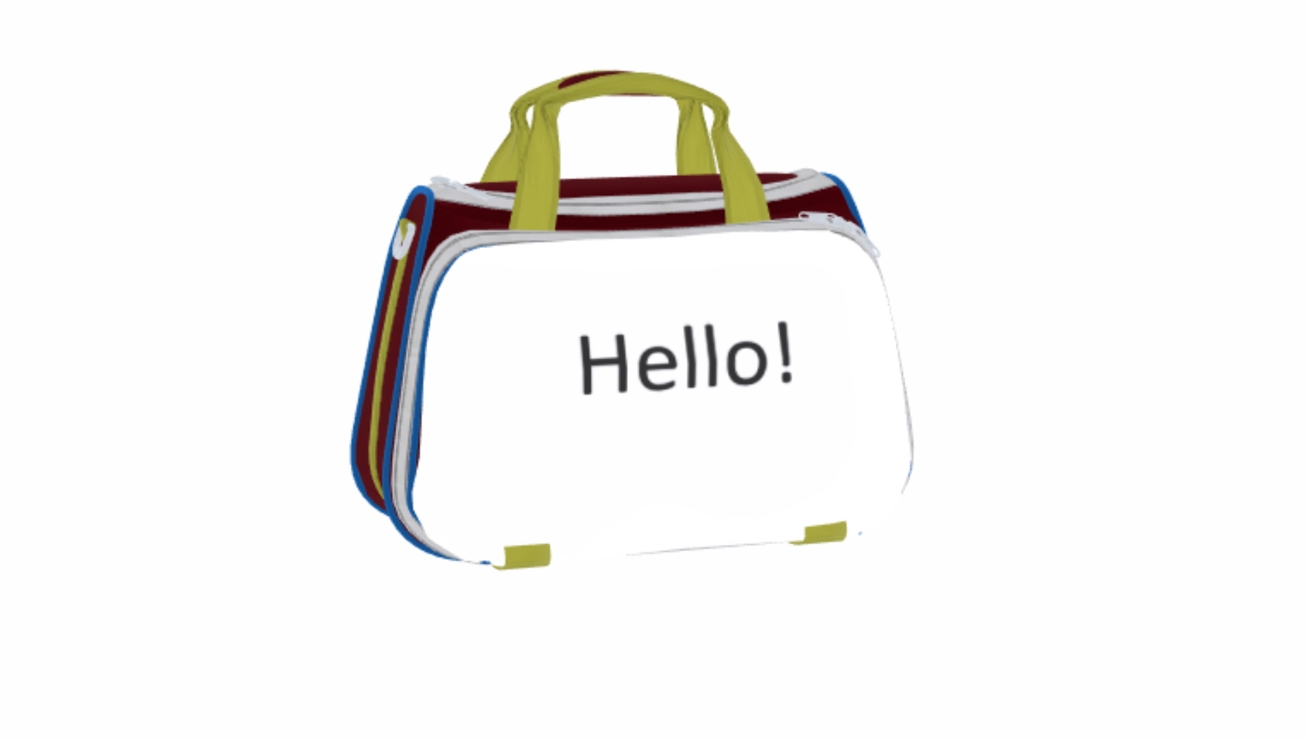

I managed to create a text editor where i can change the font, body and color of the writing, but i want the “white background” that is automatically generated to disappear so that only the writing remains, I have already tried the different methods listed above, but none seem to work.
I attach descriptive images, in image 1 I am attaching the basic material I created to write some text, in image 2 what I see for now.How can i fix it?
Thank you very much,
Kreattiva -
