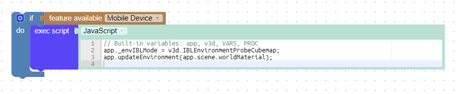

Ivan LyubovnikovStaffHi,
Is it possible to switch IBL mode in puzzles?
There’s a way to do that, although it’s a bit hackish. If you don’t use light probe objects in your scene this should be enough (light probes also need manual switching as well as the environment):
– the key puzzles are System->feature_available and Advanced->exec_script
The code inside the “exec script” puzzle:
app._envIBLMode = v3d.IBLEnvironmentProbeCubemap; app.updateEnvironment(app.scene.worldMaterial);Attachments:
