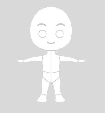

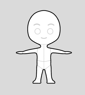

    I am creating a cartoon-like character with using Solidify modifier for having black outline.
    Though it is okay when I check Sneak Peek, the exported gltf does not show black outline.
    Please see the attached images.
    Where do I check in Blender?

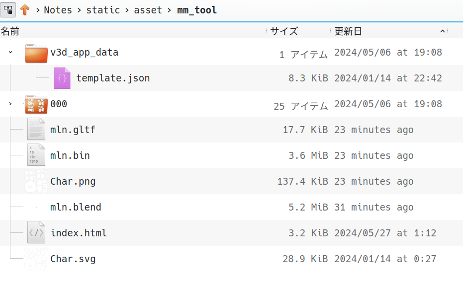

    My app zip size is 3.5MB, but it seems to be not accepted.
    Instead I attached the png of the directory.
    Please note v3d.js and main.js are outside of this folder. Probably I missed something when I moved the app files to my web site.
    #75193
    Keiko
    FYI,
    When I copied the character blend file onto “my_awesome_app.blend”, which is fresh and simple, it is okay.
    So I think I will recreate my app folder for web.
    Thank you for quick help.
