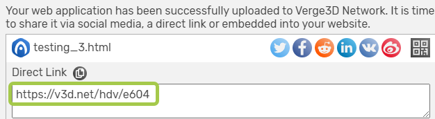

when “Publishing Application on Verge3D Network” is done, a shortlink is automatically created (ex: https://v3d.net/xxx).
Is there a way to either:
• make it so the shortlink generated is private (ex: https://v3d.net/xxx/yyyy)
• disable the automatic shortlink creation
I would really appreciate some help on this matter as the creation of the default shortlink is problematic for me for privacy reasons.

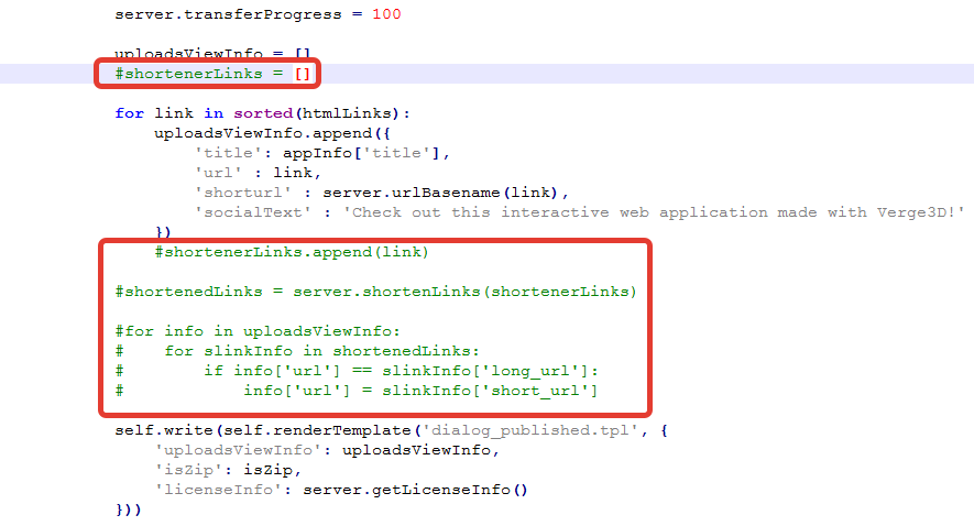

2023-04-01 at 2:38 am #61590kdv
ParticipantYou can disable the link shortener in
server.pythis way

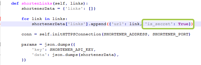

2023-04-02 at 10:32 pm #61596kdv
Participantmake it so the shortlink generated is private (ex: https://v3d.net/xxx/yyyy)

2023-04-02 at 11:00 pm #61601kdv
ParticipantDid something wrong or didn’t relaunch the Verge3D server after changing
server.py. You should disable seven lines inserver.pyand re-launch the Verge3D server. On my side it works with no problems…
2023-04-02 at 11:13 pm #61604aortalab
CustomerI tried your second solution and it worked perfectly, thanks for that!

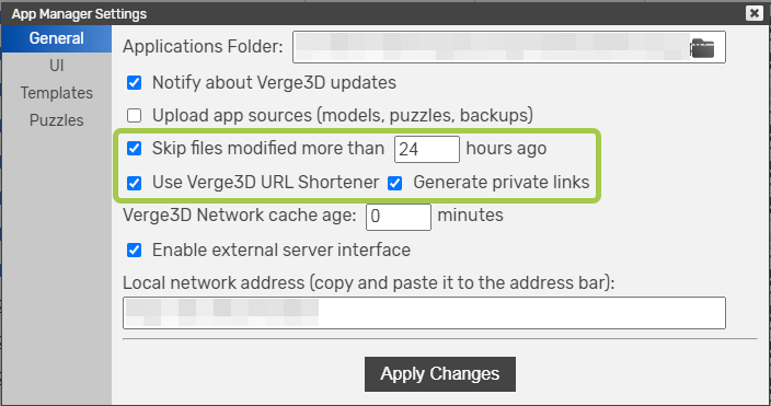

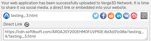

2023-05-07 at 4:39 pm #63549
Alexander KovelenovStaff• disable the automatic shortlink creation
Done!
2024-03-20 at 12:50 am #71782aortalab
CustomerIs it just me or the – ‘is_secret’: True – modification to the server.py is not working anymore in 4.6.0?
Edit: Nevermind, the server need to be stopped manually through the new interface, apparently clicking “restart” is not enough
