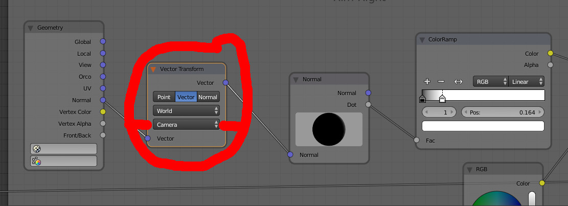

    When I check the World Space Shading in Render preferences, I find the rim light not moving dynamic depends on my view angles. Is there any way to get a dynamic Rim light on model. If appending a light source as a child of camera, It goes wrong when I zoom in or zoom out.
    Noob on blender and any other things.
    #5438
    Yes, I forgot to say. Because now normals in world space you will need to set a Vector Transform node after the Normal output to convert it to Camera Space.
    #5442
    Pepper KUN
    Thx, Mikhail. Now I can make a anime shader for my project. B-)
