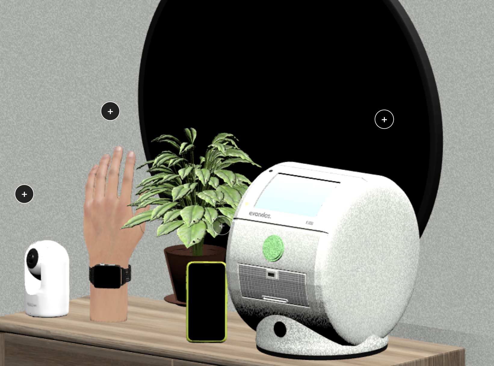

    xekich
    I have the same dilemma, mirrors and windows render black 😳
