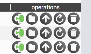

mbhladilek
CustomerHi,
I’m using Verge3D for Max Version: 4.0.1I need to generate a SCORM package but the SCORM generator icon, shown in the tutorial, is missing from the App Manager.
Am I missing something?

2022-07-23 at 7:39 am #54331
Yuri KovelenovStaffthe button is on the app screen – you can open that by clicking on the app name in the list
https://www.soft8soft.com/docs/manual/en/introduction/Creating-SCORM-Courses.html
