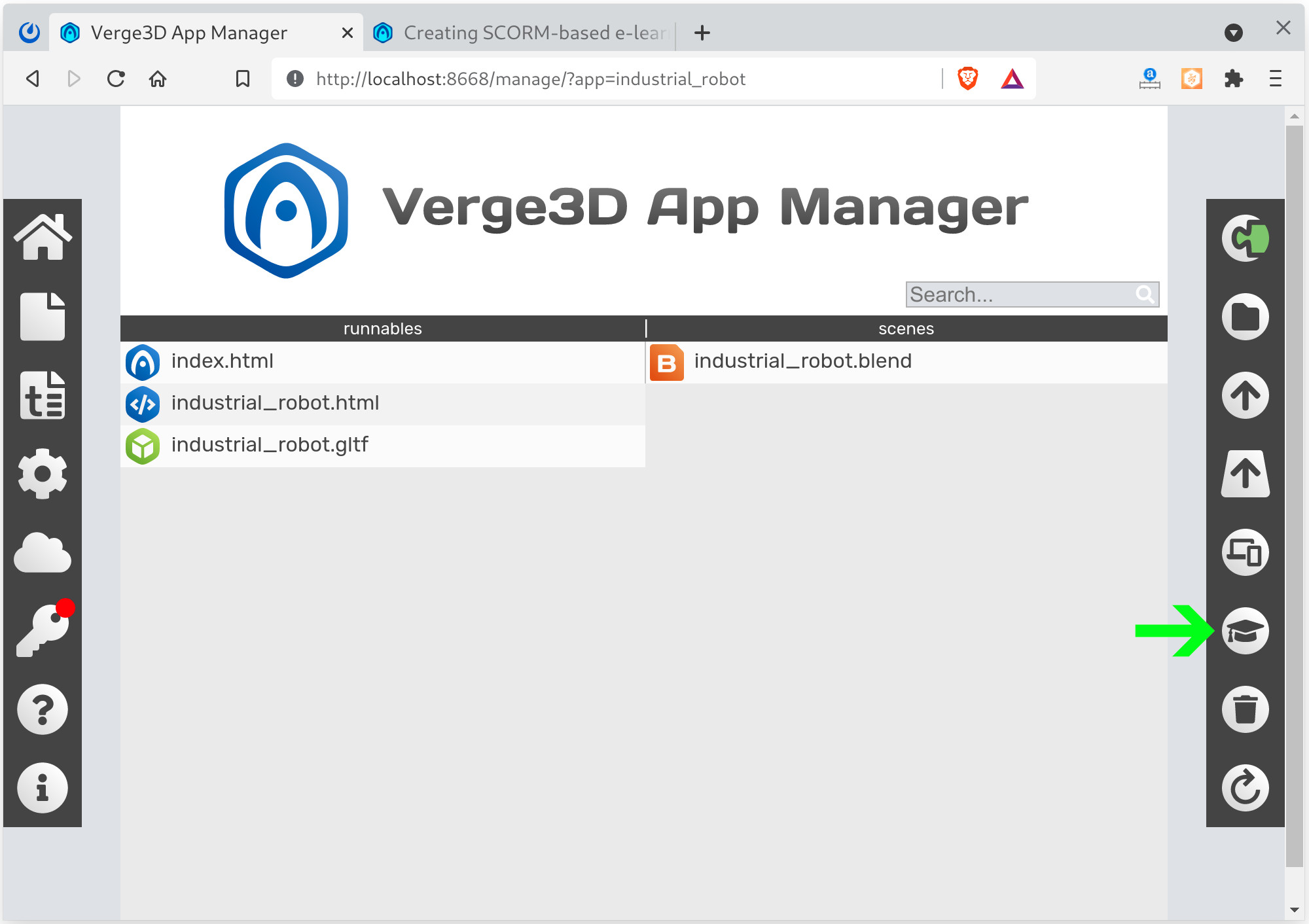

Verge3D App Manager comes with a built-in SCORM generator. Just click on the following icon:

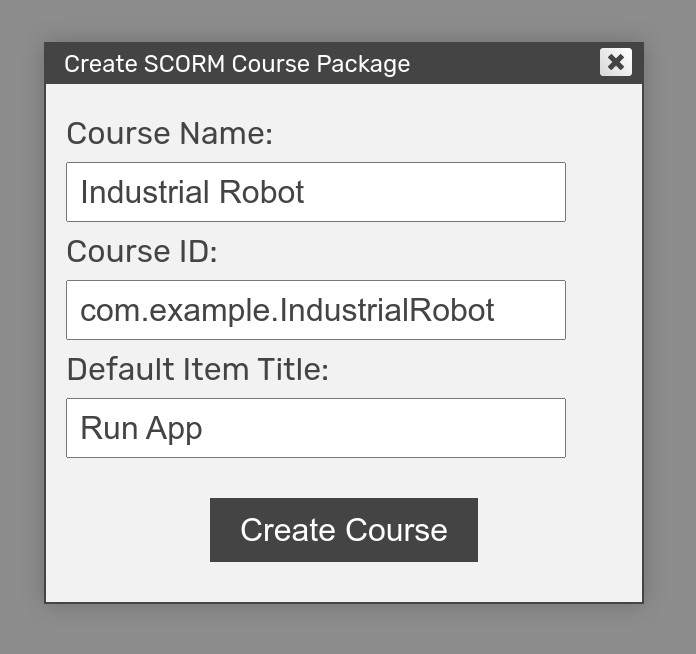

    Then select course name, course ID and default course item name in the Create SCORM Course Package dialog:
    Once created, download the ZIP archive with the SCORM course to a directory of your choice.

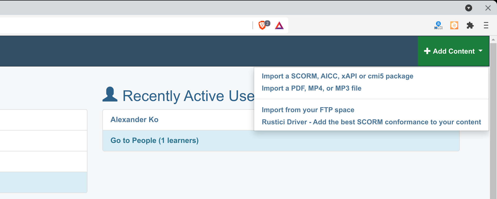

Login to your SCORM Cloud account and click on the Add Content button in the top right corner, then select Import a SCORM, AICC, xAPI or cmi5 package:

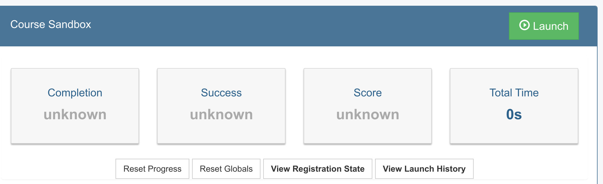

    Wait for upload to complete, check that no errors happened during that process, then click Launch located on the Course Sandbox panel:

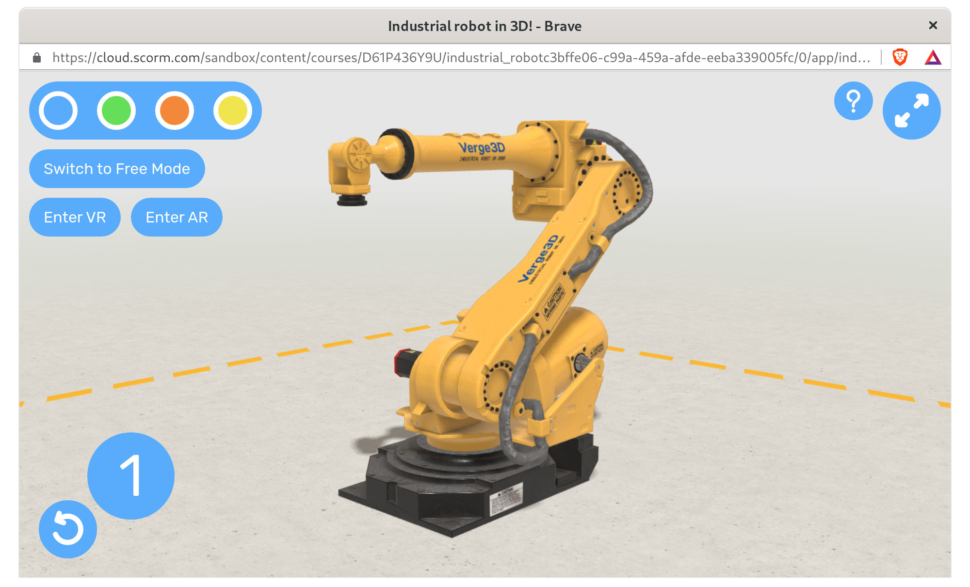

    Enjoy the course:
    When you're done, simply close the popup window to return back to the SCORM Cloud course configuration page.

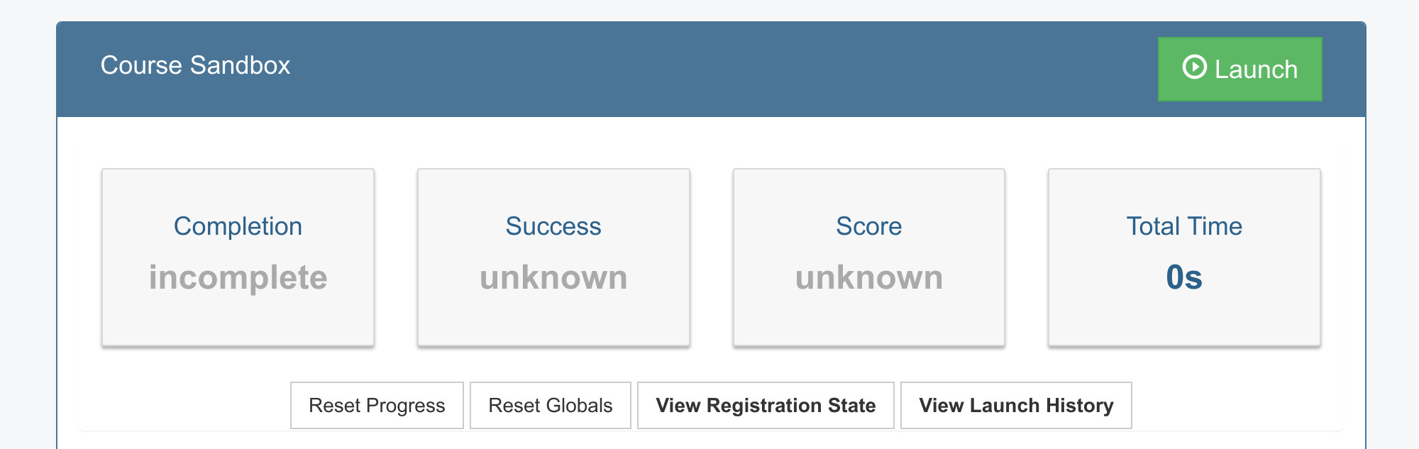

    Note that we've got the completely meaningless statuses on that page. To make the LMS record our progress we need to use the SCORM API. Thankfully, Verge3D includes easy-to-use puzzles to make things as simple as possible.

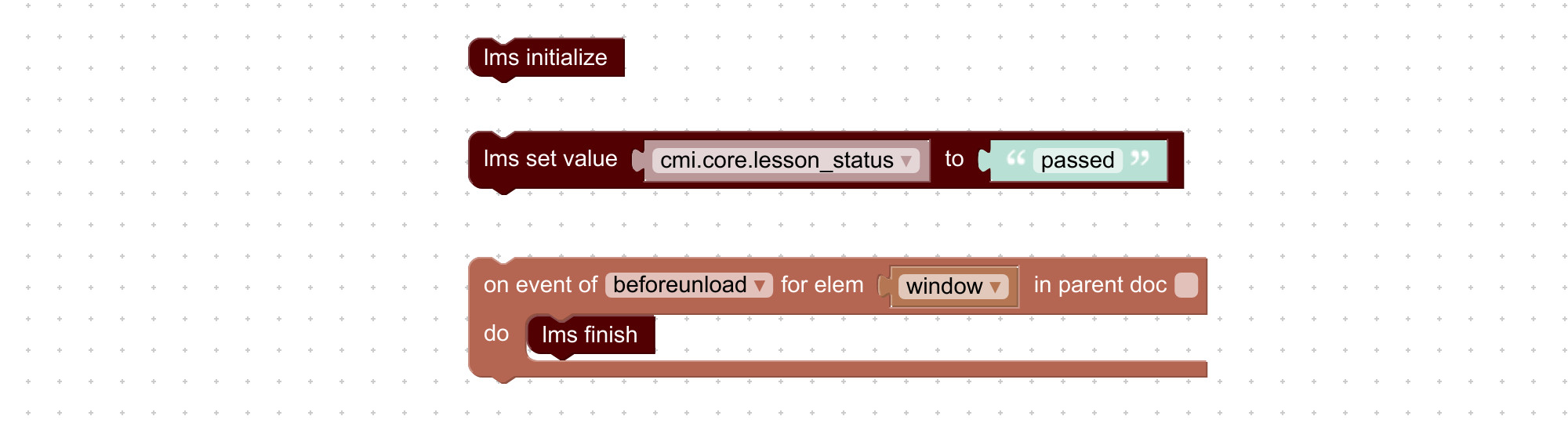

The minimal set of features we need to implement in a SCORM pack would be:
- Initiating a communication session with the LMS.
- Reporting a lesson status, such as "incomplete", "failed", or "passed".
- Finishing the communication session.
The puzzles implementing this are simple:
    The lms finish puzzle executed in the beforeunload event handler (fired when the page closes). This is a good practice since we may do more communication with the LMS during app run time.

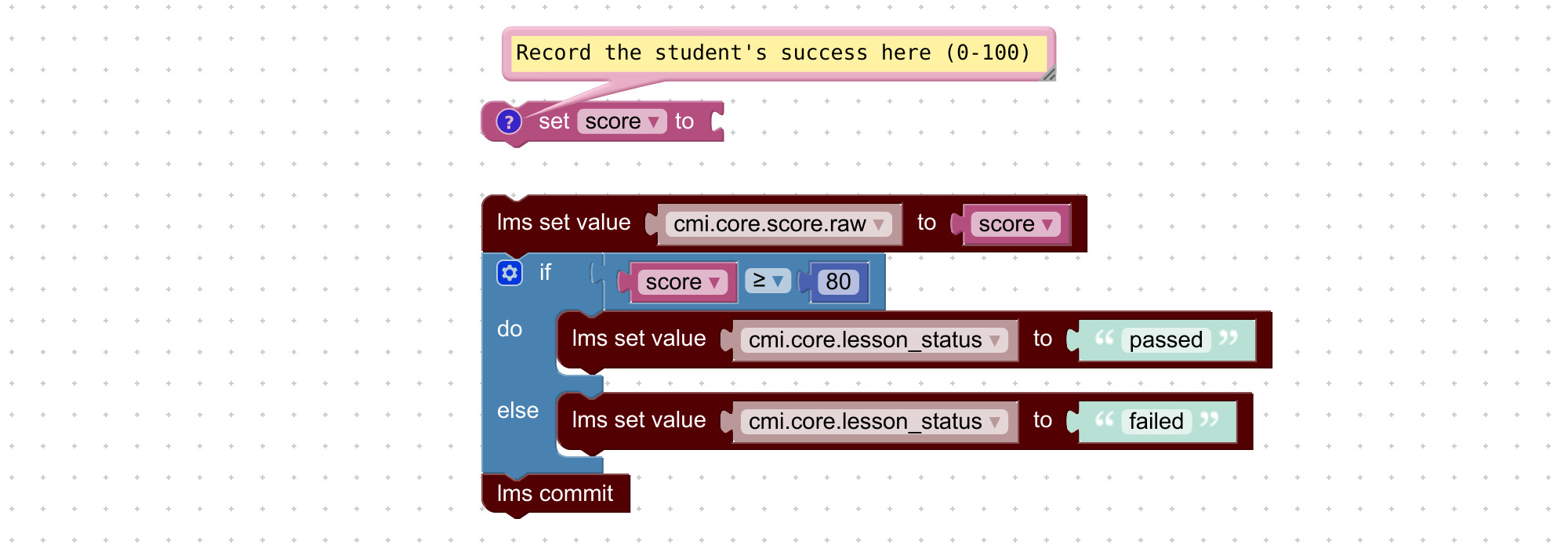

In many cases, reporting the lesson status is not sufficient. You might need to track achievements of the students as well. For this, store a score value to the cmi.core.score.raw element:
    We used optional lms commit puzzle in this snippet to improve UI responsiveness of the LMS.

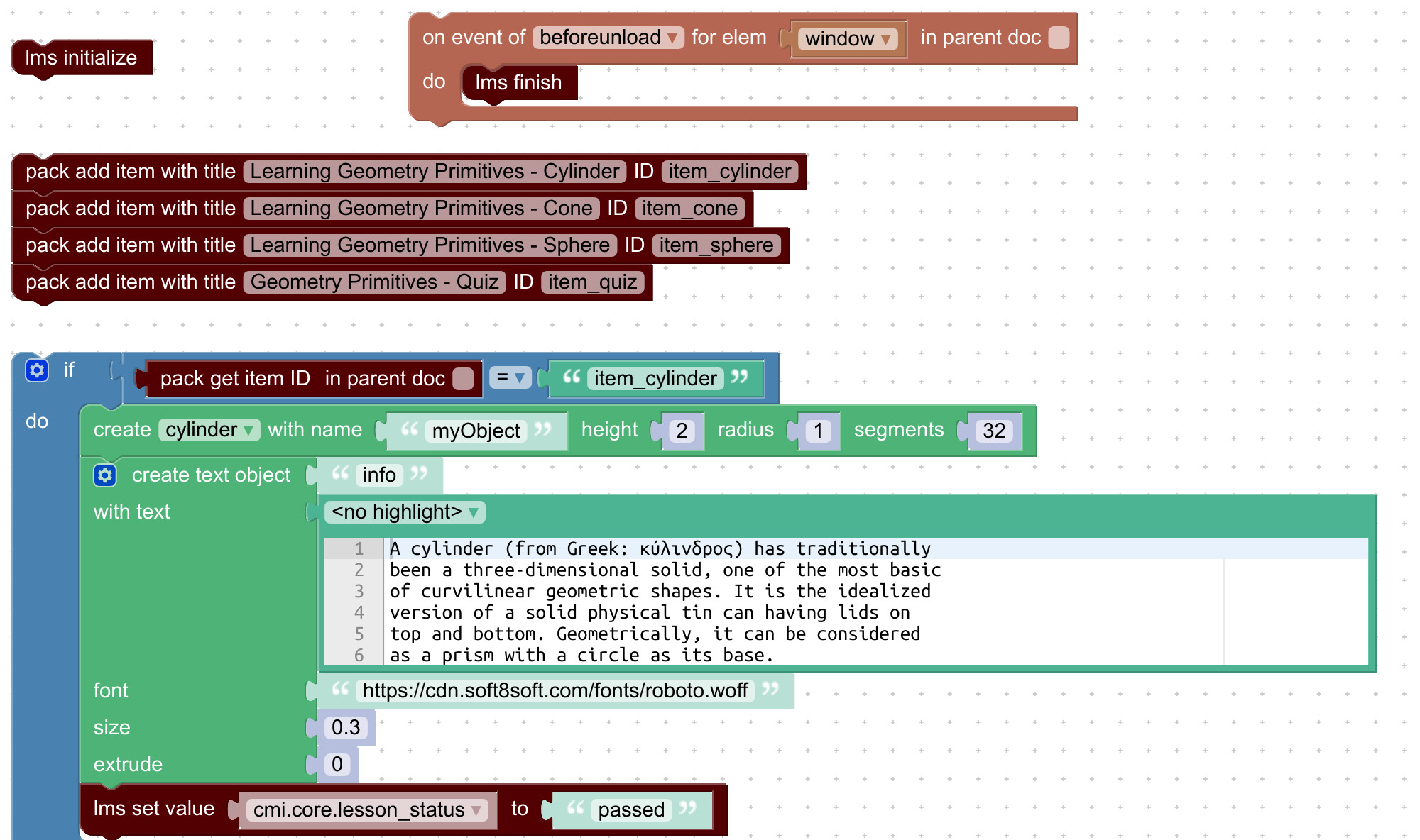

You can use multiple web pages (hence multiple 3D apps) in the same SCORM pack. However, we don't recommend this method since it will make things quite complicated.
Instead, there is the pack add item puzzle to add page-like items to the course. To make your app respond to the selected item, use the pack get item ID puzzle. For example:
    Download the example project here.
Make sure you set proper lesson status for each pack item even if you have no questions/quiz there (in this case just set the cmi.core.lesson_status element to passed once the user has loaded the page).
