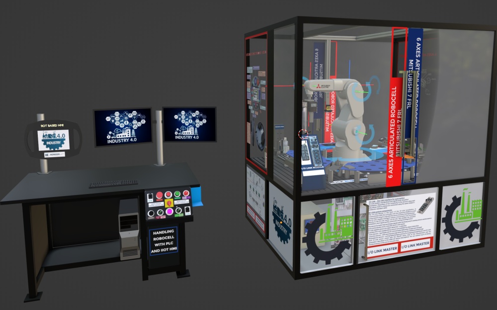

    My current WIP image screenshot is here. Soon I shall upload it for our forum members to view as well.
