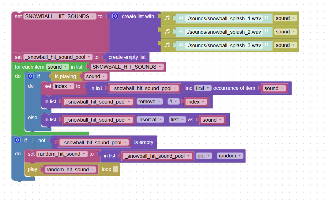

    Just copy the sound three or four times (for example sound_1.wav, sound_2.wav) and then play them randomly with checking if the current sound is playing or not. You can find a working axample of this in Snowball_VR demo.

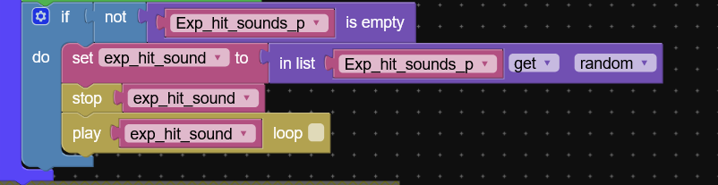

    c4cc
    Thanks, I tried it but sadly sound did not restart while playing when player came into contact with other items. sounds only restarted when it finished.

    stop sound;
    play sound;

    c4cc
    Tried it, still doesn’t work.

    c4cc
    This works kdv, thanks. Need to run a couple more tests though to be safe.
