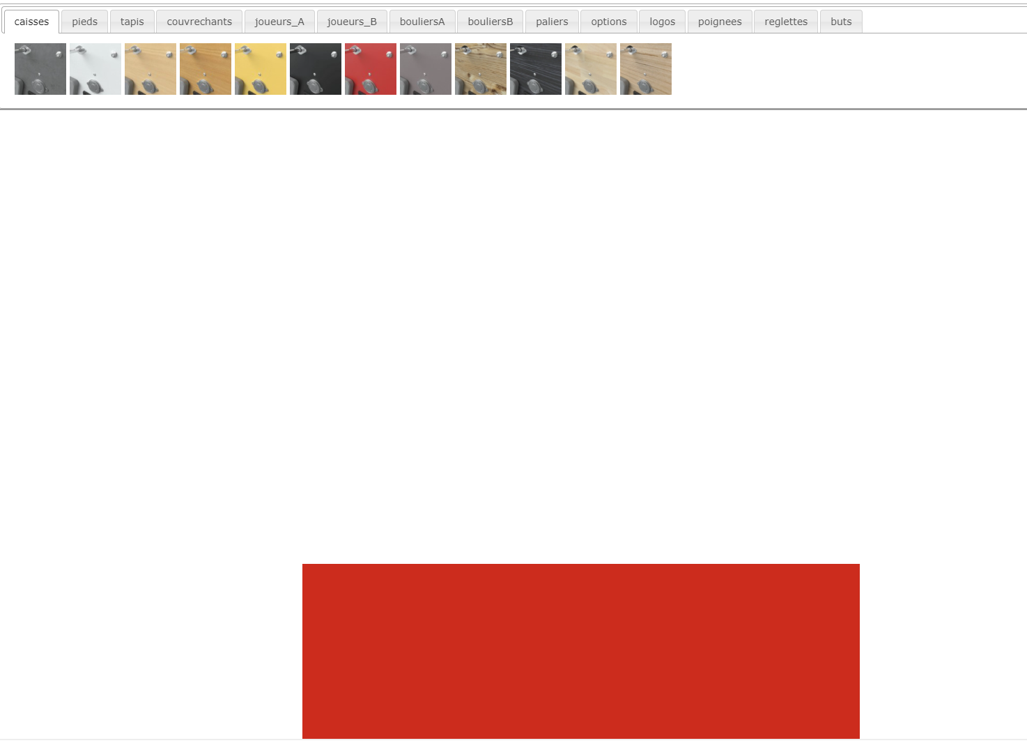

    Same error :
    please see picture.

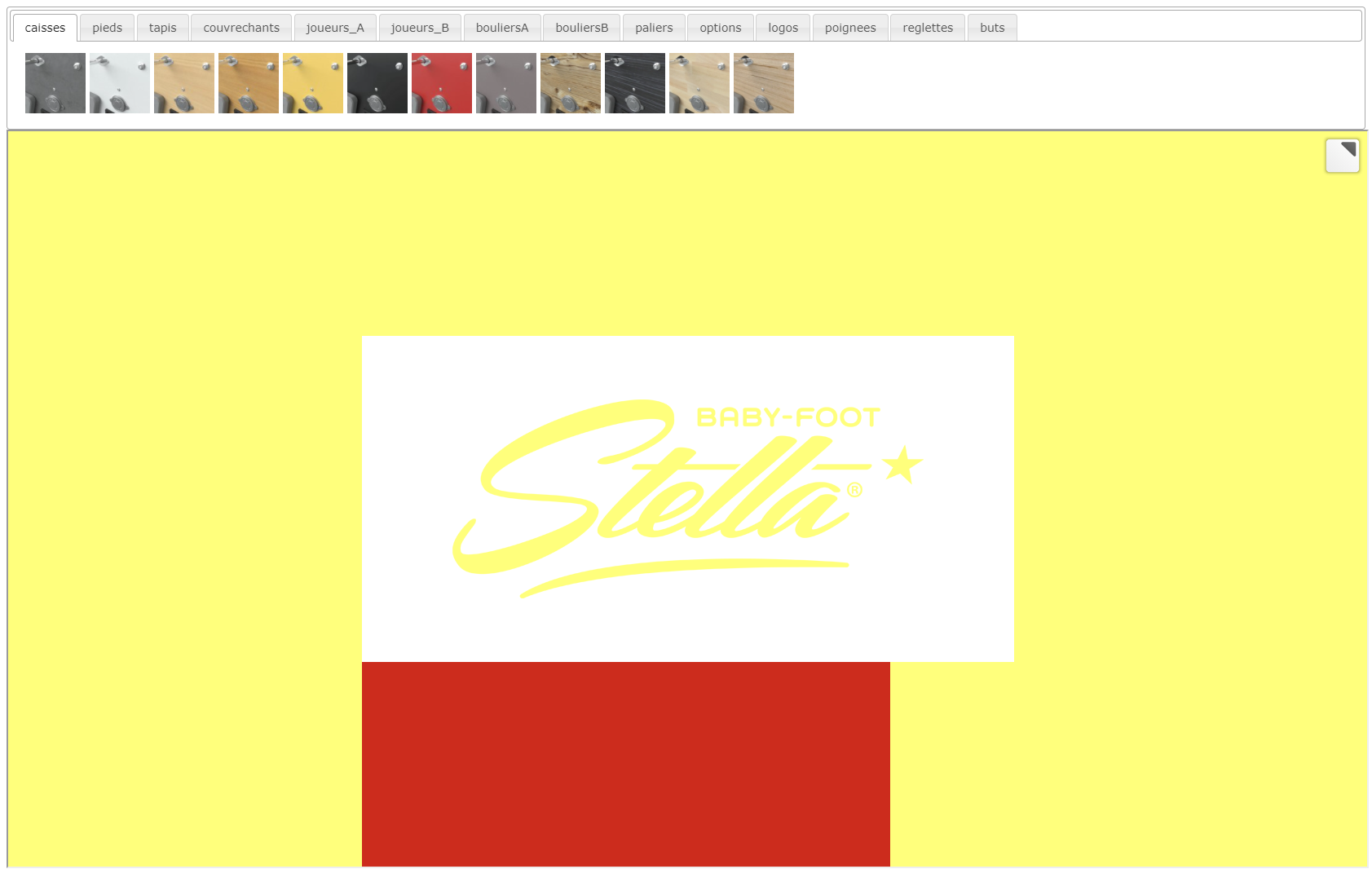

    I thought to change the background color so i can see that the logo is well found, but the red growing div seams to go under it in y position, not in z-index.
    Again, i did not change puzzle, but i’ve upgraded to last Verge3D.

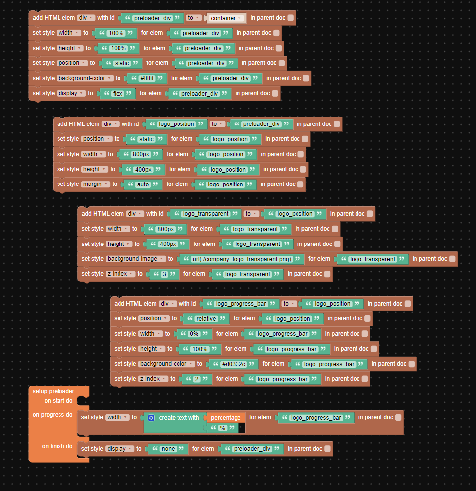

    Hey Naxos, maybe I found it!
    On your div logo_progress_bar, you’ve set the position to relative, but in the green puzzle you’ve written logo_position instead of logo_progress_bar.
    Is it solved now?

    Here is the project, so you can look puzzles :
    https://we.tl/t-wbrKIRJ7Ya
    Thanks for your help.

    Try to set the z-index of the logo_transparent div to 1.
    Then set the z-index of the logo_progress_bar div to auto.
    In my case, it works. In yours?
    #36404
    Also, I found this on w3schools.com:
    z-index only works on positioned elements (position: absolute, position: relative, position: fixed, or position: sticky).
    So, add a set-style puzzle to logo_transparent div, and set position to absolute.
    Let me know what happens.

    Hello Vassili, with both z-index changes and set position add, it works again ! Many thanks !!!
