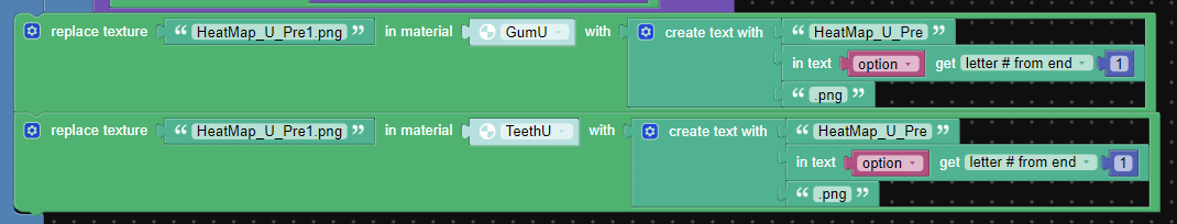

I though I was being smart by reducing the number of meterials in my scene and using replace texture instead, but now I have an lag issue and I hope you guys can tell me what I have done wrong!

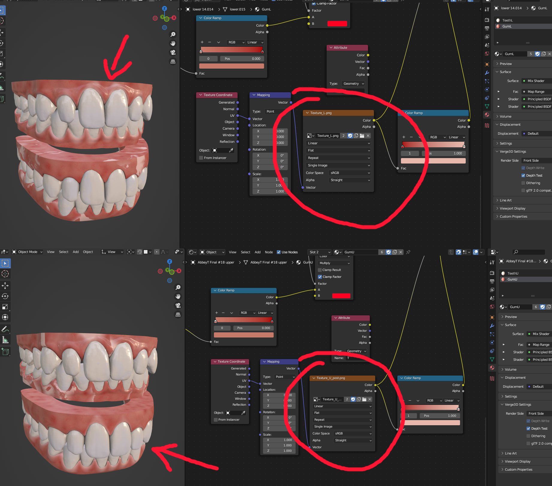

I have two different object with different UV but the same materials.

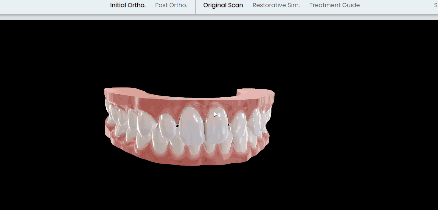

I use the replace texture to make sure that as I switch to the other object the material change accordingly.It works… but as you can see in the .gif that I linked, it lags before changing to the right texture.
