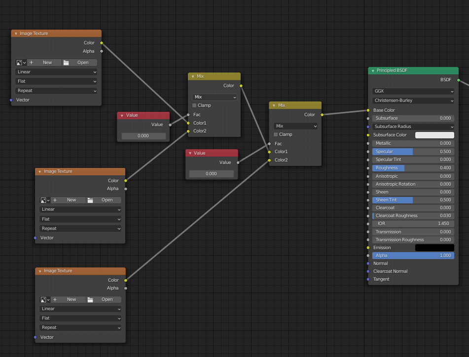

If you have only 2 or 3 texture to change you can put them directly into your main material and combine them with mix color node with connected value to the inputs of this nodes and switch them even smoothly.
