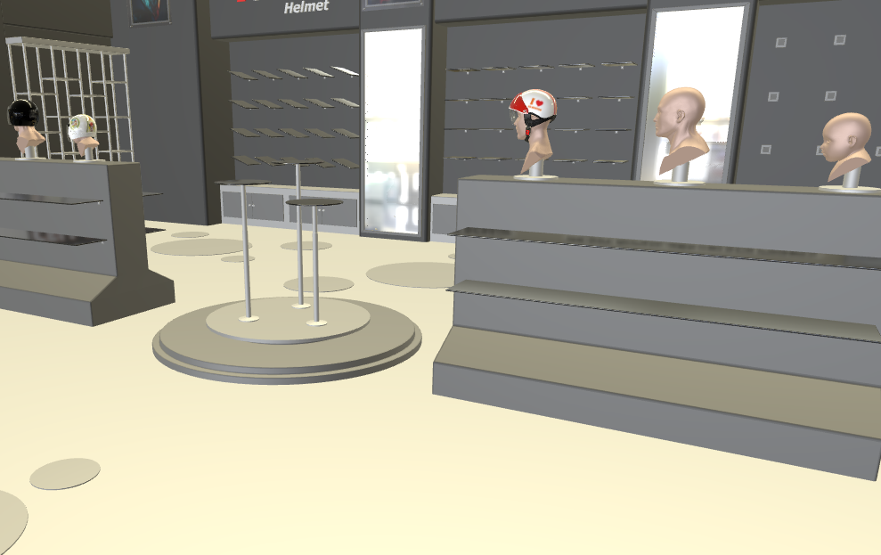

    Hi, i am just started looking at this software and it looks incredible with so much potential it has. I have made a test scene here with basic HDRI and sun setup.
    1)Shadows looks really bad,how can i increase the overall quality of scene so that shadow gets better and flickering is removed?
    2)Reflection doesn’t look right after i have exported as Gltf as they look in blender. I can only see HDRI reflection on the reflective sphere and not the geometry reflection.
    3)Is there any tutorial on how i can setup walk mode for the scene?
    4)Is it possible to create different camera angle buttons? so that user can user can navigate to different view after clicking some button?
    5)Can it handle bigger scene like in the below example if we have 10 more of the same geometry?

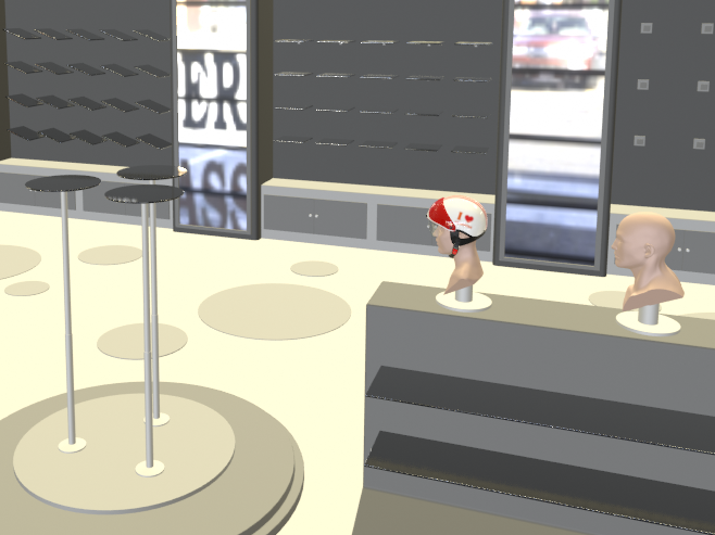

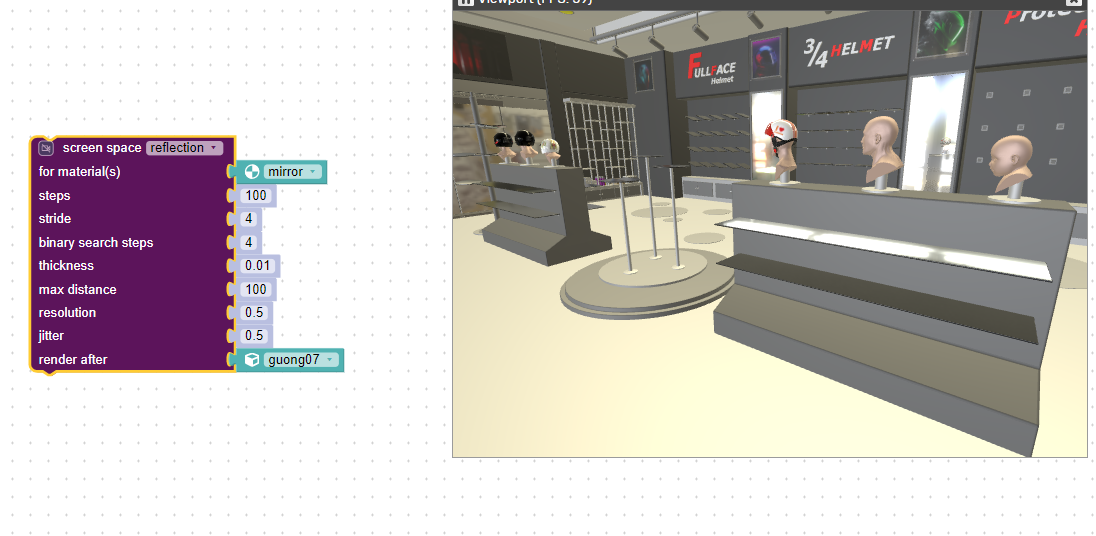

    Hi Yuri,
    Can you help me setup SSR ? I follow the instructions but not work.

    we’ve checked your file. SSR effect does not support objects with zero thickness (as your walls, floor and ceiling has). Please try to make them thicker (like in the real world).
    Also, I’m going to add support for planar reflections in our TODO list. We’re thinking about implementing better algorithm suitable for mirrors and similar simple objects.

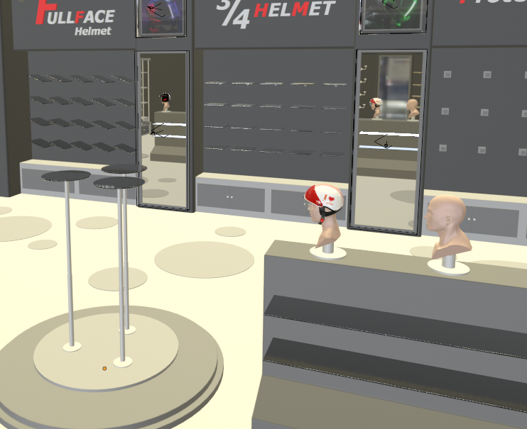

    lamthanhle
    I’ve try as your suggest and SSR work but not good.
    Waiting for support plane reflection :good:
    Try to increase steps to 400 and set quality to 1, this must help a little bit.
