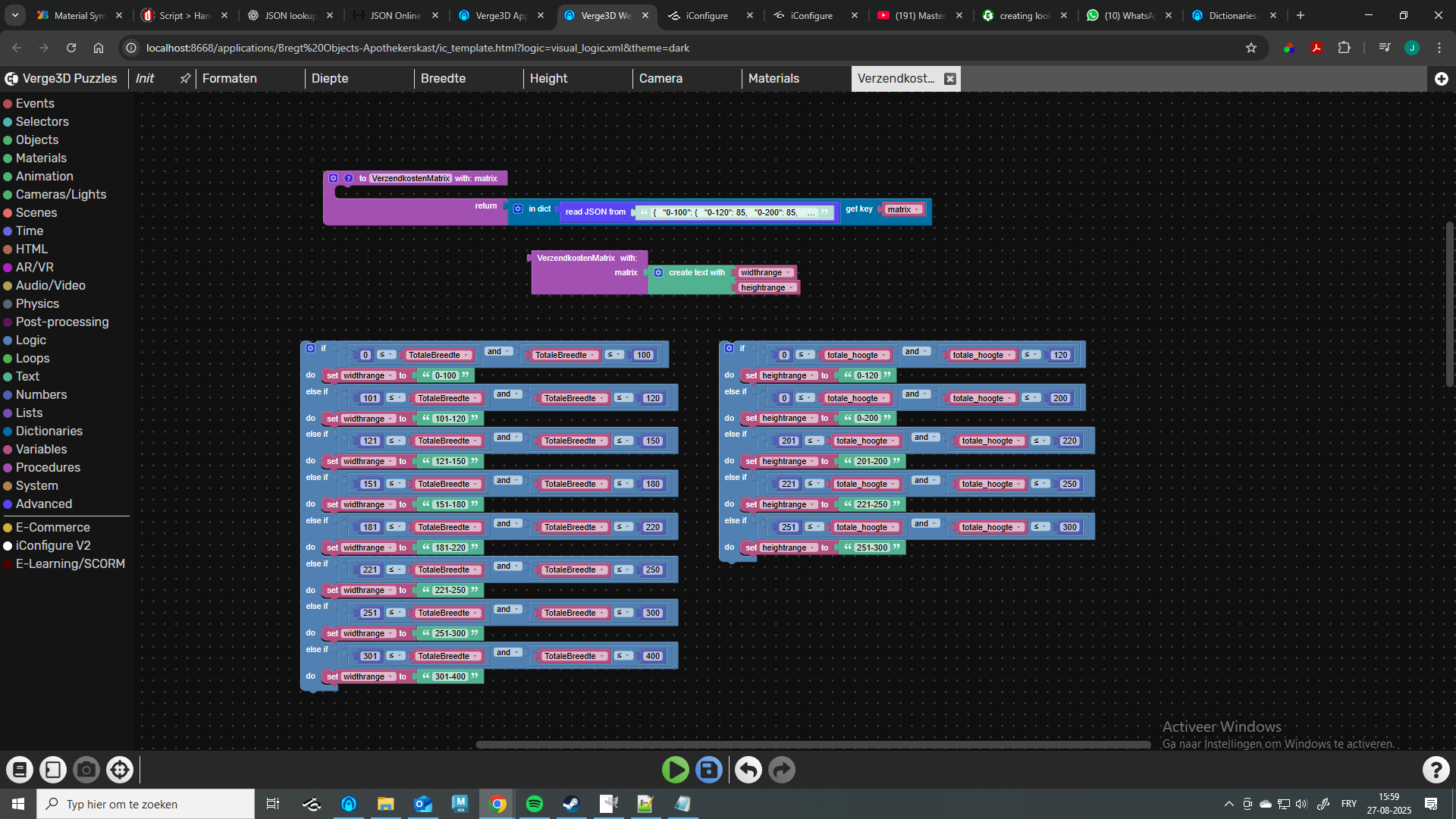

    I am currently working on a function in Puzzles to read out a JSON file, and output the correct number. But somehow I can’t seem to read it out properly. It is a nested JSON, and I’ll put it in the attachement of this post, along with my Puzzles structure. Could somebody help me figure out how to read these values out?
    Thanks in advance!

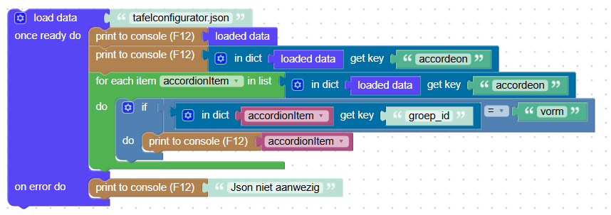

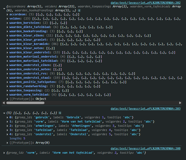

    It has come to my attention that I should probably use “create list” instead of “create text” puzzles. It shows up correctly in the console now when I print, but it can’t yet read out the JSON file for some reason.

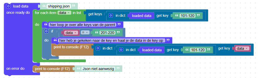

    I made a quick example for you with logging and puzzles basics.
    This is one of the ways to get the information from a nested json.
    Depending on what u want/need u can rebuild this to fit your needs.

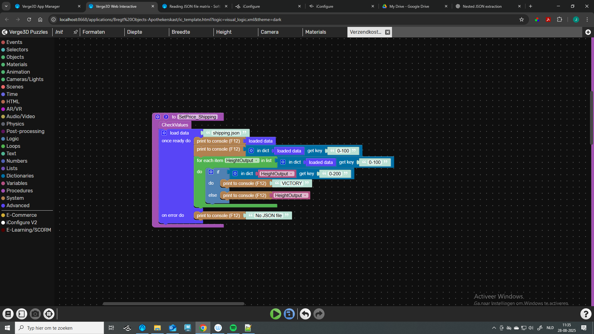

    I am still unable to read it out. I’ll put the code in down below.
    The thing is that I need the keys to be flexible. When the user selects a certain size (both width and height), it should automatically use the JSON as a look-up table and get the proper value. That’s the context for this file, and that is why I’ve ordered it this way.
    Json file
    When I print the loaded data and in dict get key they do show up. But when I try to get to a key within the key, it seems not to work. Some additional information would be appreciated :) Thanks in advance
    #84324
    jelteh
    This is what I recreated btw, but I cannot get it to give me a key within a key…
    Puzzles
    • This reply was modified 1 year ago by jelteh.

    Roel
    This shows how to get the key in a parent object.
    From that u we print the value.
    But for your needs i think u have to make it a bit more dynamic.

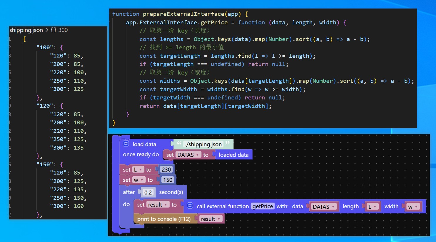

    The logic might not be perfect. We can test it out.
