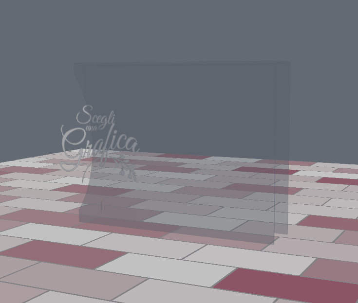

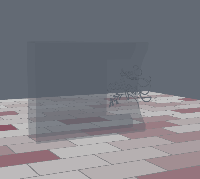

CustomerHi i need help to solve a problem with transparencies in blender 4.2. in this link https://v3d.net/178f you can see that if i rotate the view the image that is in the middle of the transparent object depending on the angle disappears or creates an artifact (this can be seen if i place the view on the back) how can i solve it? Thank you
ps:this happens when there are two intersecting objects that have transparency effects
none of this happens with blender 3.5

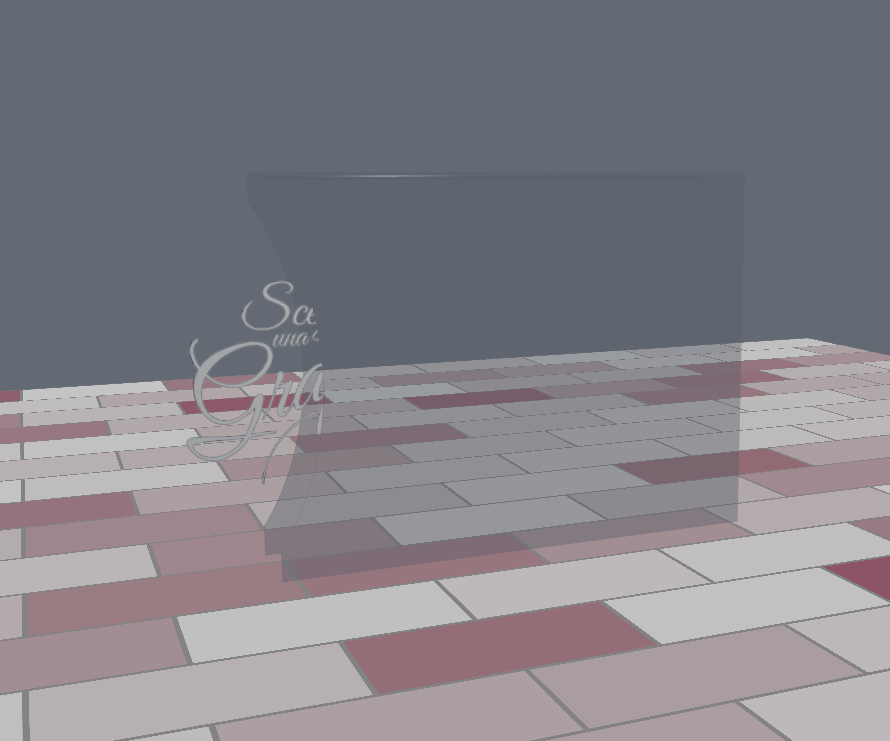

Participant1. Disable Depth Write for both materials (Material parameters in Blender)
2. Increase render order for the outer part by 1 (Object parameters in Blender)the result should be like in this video
2025-01-31 at 7:32 am #80045michele tamborino
Customerwow
it works thank you2025-01-31 at 8:14 am #80046michele tamborino

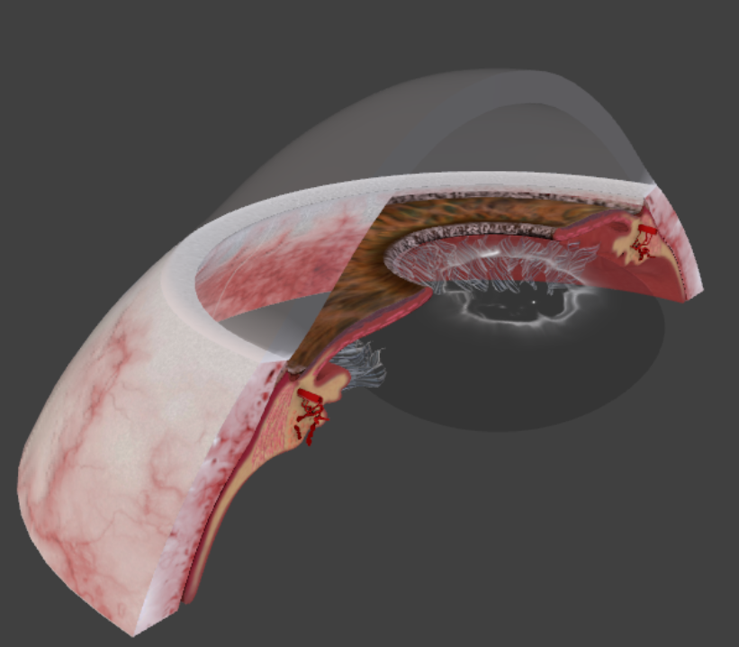

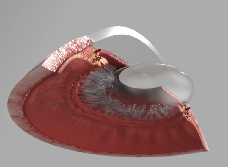

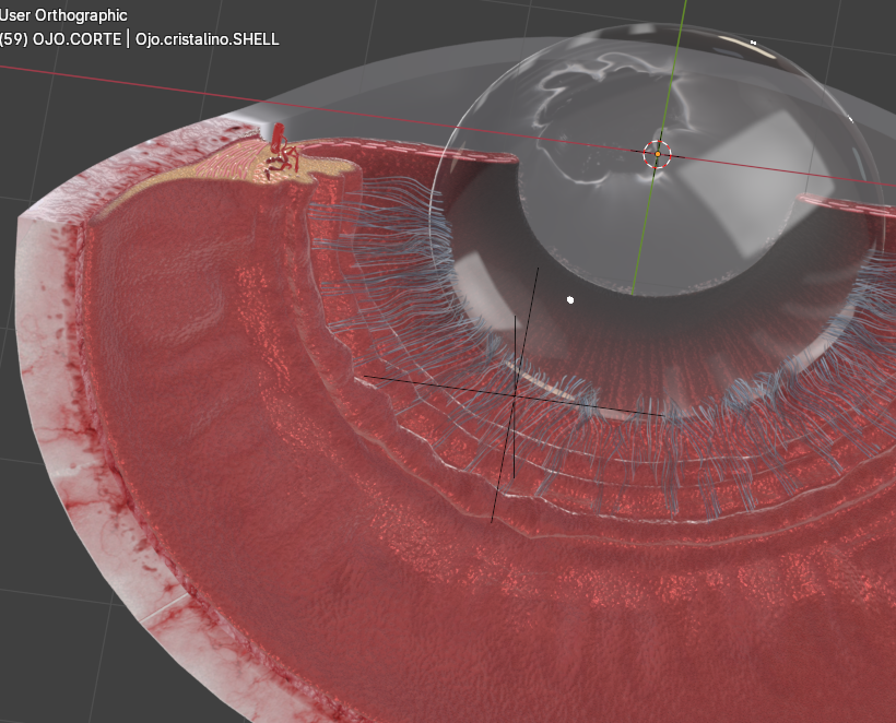

ParticipantHello, I am having a related problem with transparencies from Blender to Verge. Images below show both views (Blender is the desired one).
I feel lost in the mud of parameters, deactivated depth write, used order-independent render, activated transparency overlap and tried hundreds of combinations with no clear result…

ParticipantFollow up:
Managed to get it working by trial and error…
-Did not activate “Order Independent Rendering”, because it made every object as see-trhough.
-Activating “Depth write” in some objects, gave the same see-through result, but not always (?).
-Tweaking “Rendering Order” is tied to the object´s Origin position and NOT its actual geometry. (Changing the object´s origin will yield a different rendering order, even if the actual geometry was not moved).
