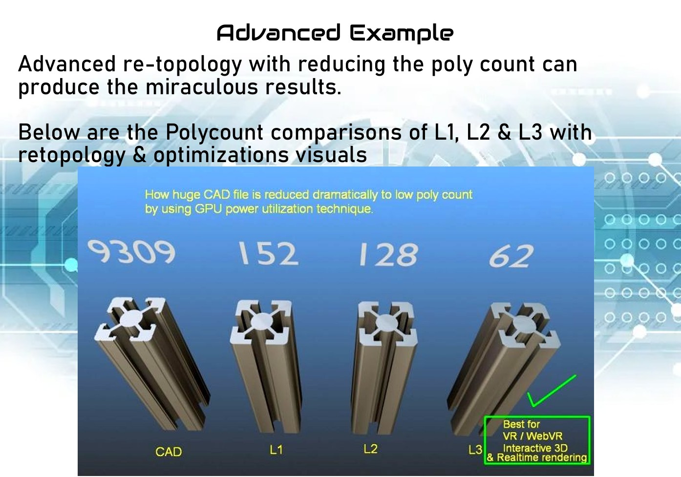

2025-03-15 at 8:18 am #80623
visualizerParticipantJust
FYR
here is just reference screenshot of the many tricks of optimizations we always use with verge 3D.Attachments:
