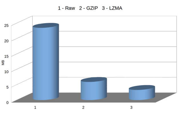

In Verge3D, scene files may be compressed using the highly effective LZMA compression algorithm, thus allowing to significantly reduce the size of the files. At the same time, LZMA offers fast decompression on the browser side. Typical compression rates observed for Verge3D scenes are: 20x for the .gltf files and 6x for the .bin files.

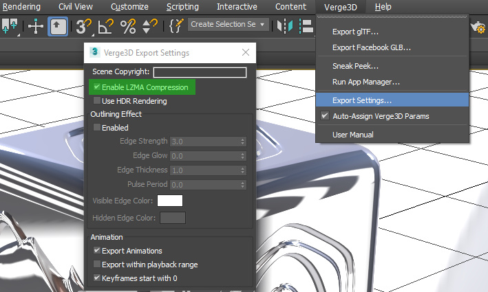

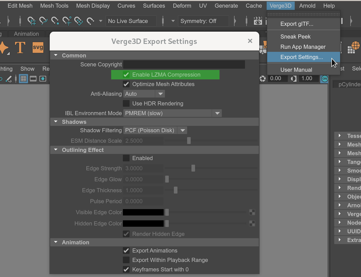

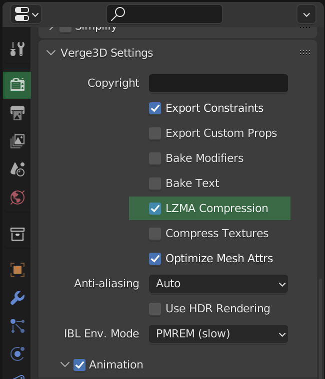

Exporting Compressed Files

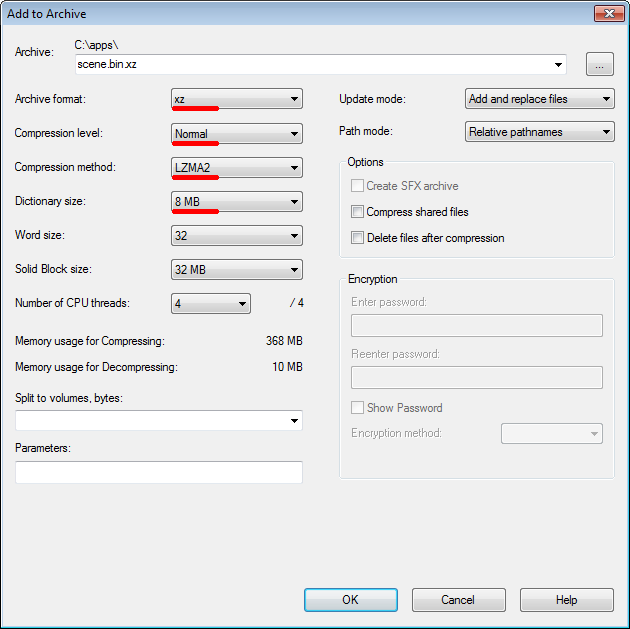

Verge3D supports loading of scene files compressed in the .xz file format, which incorporates the LZMA compression algorithm. To enable creating .xz files automatically upon export, you can simply turn on the corresponding option in the export settings.

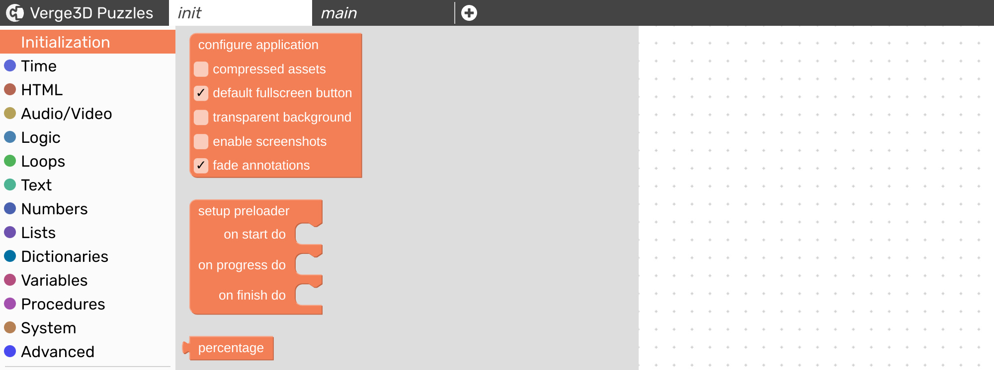

The compressed .xz files (for example, my_awesome_app.gltf.xz and my_awesome_app.bin.xz) should appear near the original ones. What is left is to enable loading them in your app. To do this, go to Puzzles...
...and switch to the init tab:

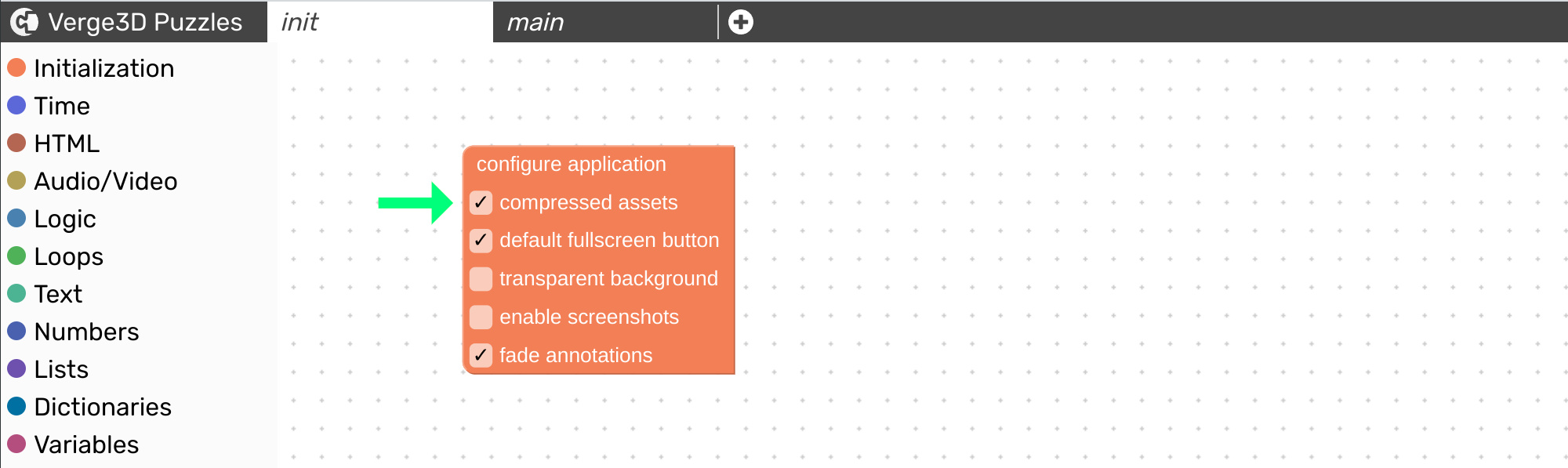

Drag out the configure application puzzle from the Initialization category, if it is not already present in the workspace, and turn on the compressed assets checkbox on it:
Finally, click the Save button. That's it!

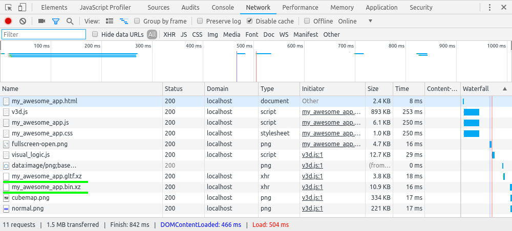

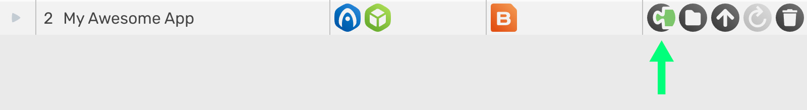

To ensure that your app now actually loads compressed assets, run your app (either from App Manager or from a website where it is deployed). Open the browser console and switch to the Network tab.
Reload your app so that the console starts displaying files from the beginning. Find the scene files in the list - if everything is ok, they should end with .xz.
