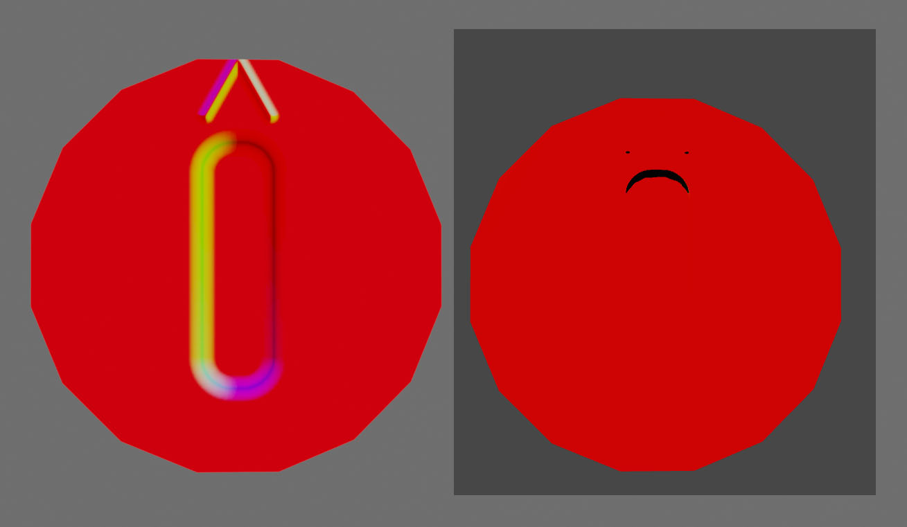

    I’ve got a problem with material export from Blender 4.2 + Verge 4.7.1
    Normal Map node uses UV layer, which was manually selected in the mesh data tab, but not the one specified in node’s settings.
    “Sad smile” from the right of attached picture is incorrect UV layer export (sneak peek)
    #77735
    Just do not use the NormalMap node without Shader nodes (Principled, Diffuse, whatever). Normal output is not supposed to be connected to Surface input. And your scene has no lights to see your normals…
    And keep in mind that Blender and Verge3D are two big differencies.
    #77743
    sergeverge
    This is just stripped example to explore the problem.
    It doesn’t work no matter what lights or shaders are used, I stil get wrong UV layer for Normal Map tangents.
    #77747
    Unwrap the second UV (even with different scale or shape) and it won’t be a problem. Looks like a point UV is the culprit. And yes, manually selected UV somehow affects the result in V3D.
    #77762
    We managed to figure out why it’s happening. The fix is on the way!
    #78234
    Should work now!
