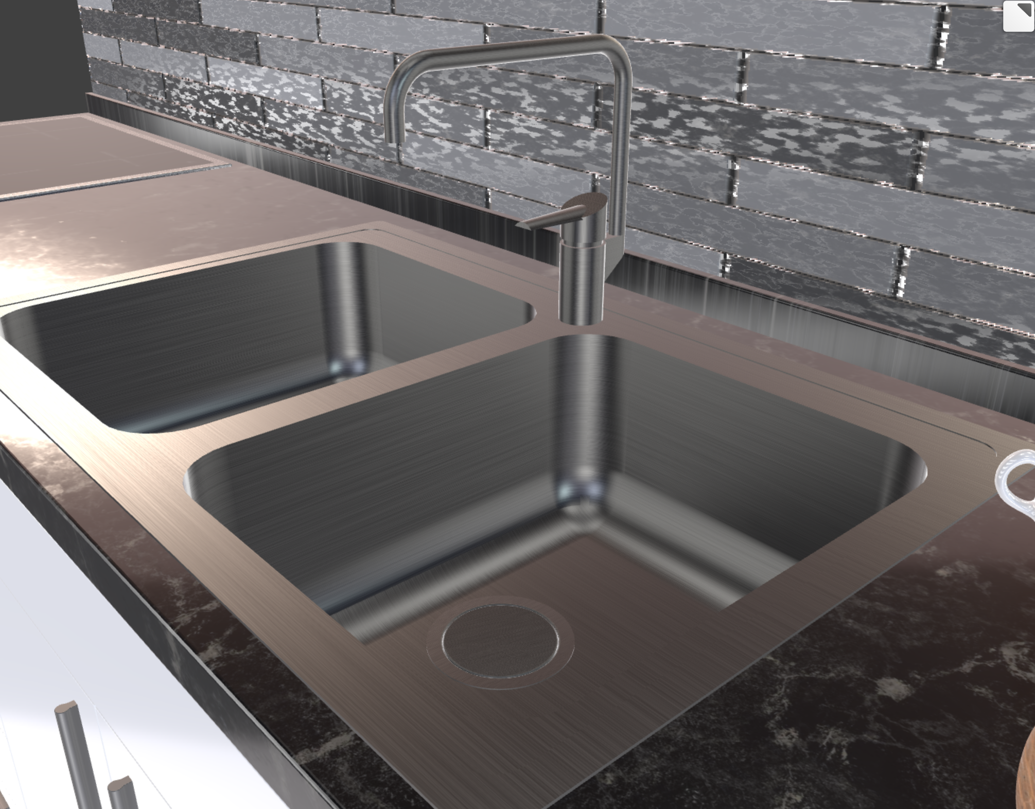

    pekkizz
    I got it :)
    I unwrapped my kitchen sink and now it works ok:
