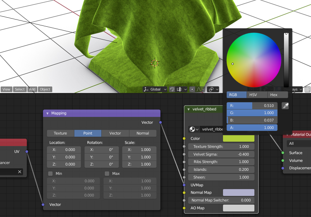

Most of the shaders offer sets of inputs by tweaking which you can create a unique material suitable for your needs.
    Besides that, there are special inputs for easy connection of baked normal and AO maps.

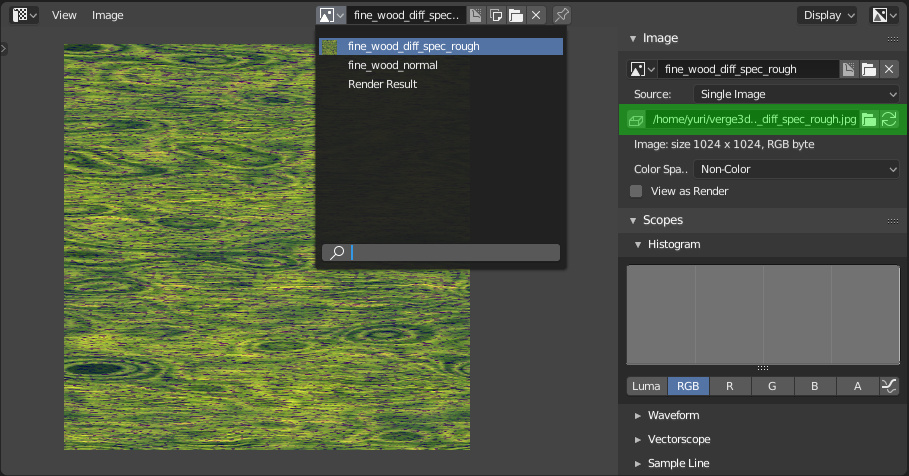

Open the Image Editor (or UV Editor) in Blender. Select a texture from the drop-down menu, and check its file path.

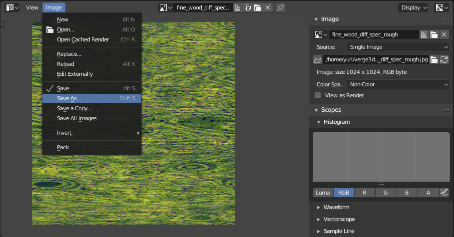

    If it appears that the texture is referenced from the material library folder, use the menu Image → Save As to re-save it to your application folder.
    Search for other material library textures and repeat this operation until all textures are relocated.

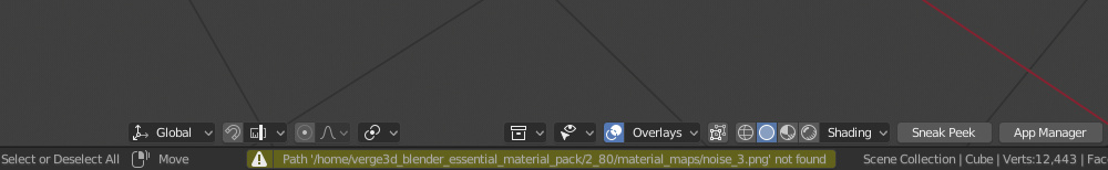

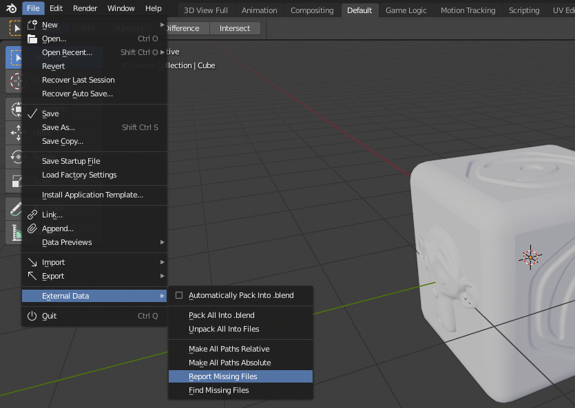

You can check the integrity of your application by moving its folder to another location in your file system. Open the .blend file and invoke File → External Data → Report Missing Files.
    If any of the textures used in the .blend file are missing, a yellow splash warning will be shown at the bottom.
