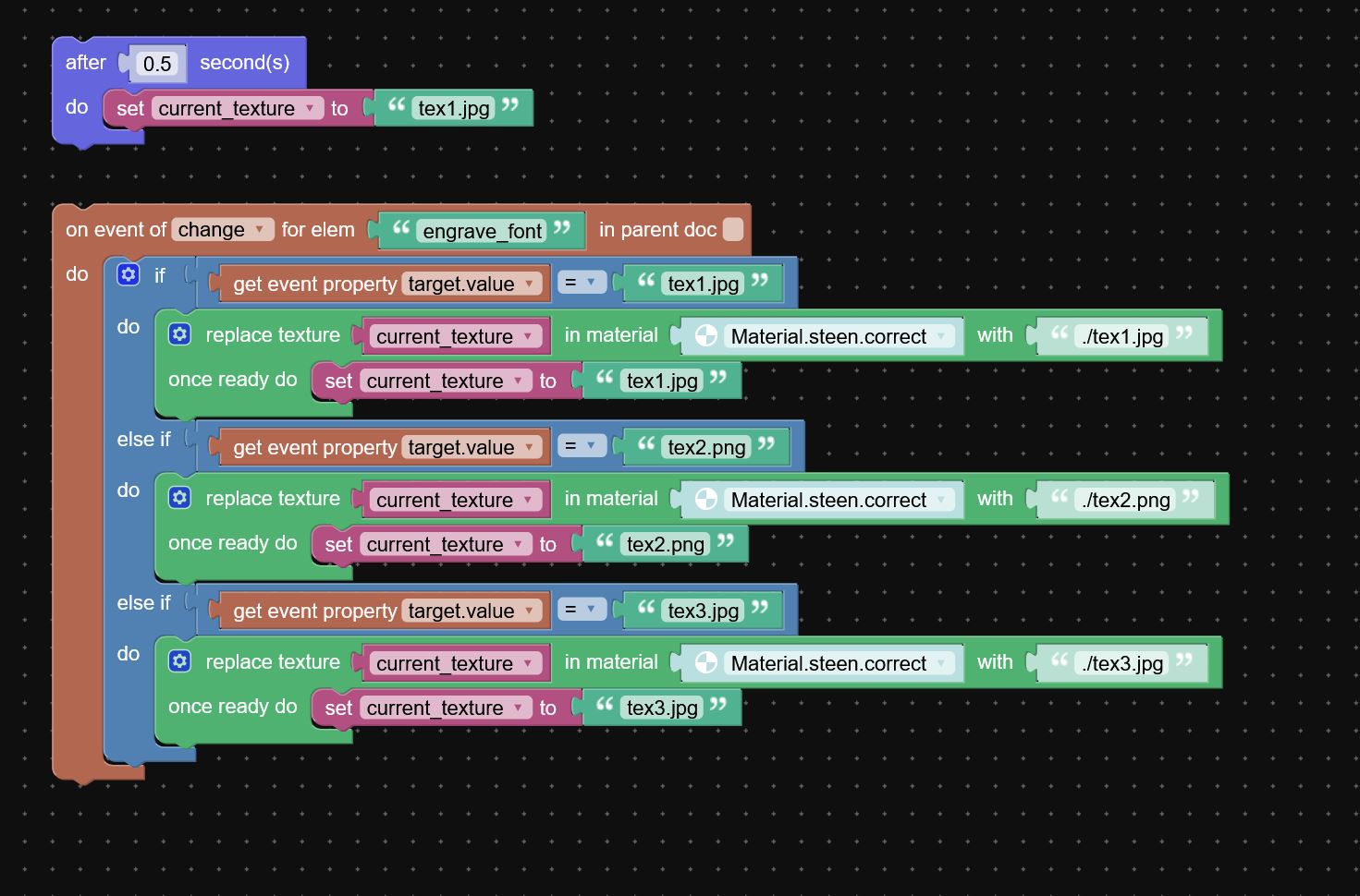

My menu consists of 3 textures replacements on the object.
Which texture is the current one (and should be replaced) is kept in a variable “current_texture”.But my logic only works the first time when a texture is replaced, after that all options don’t work no more.
Any ideas?
You must be logged in to view attached files.2023-08-16 at 6:14 pm #66204xeonCustomerOK so you can actually do this with textures. Keep the original texture name in the replace texture puzzle. Do not change that with the variable you have now.

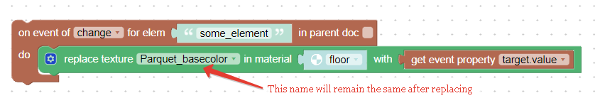

Tutorials - https://www.xeons3dlab.com2023-08-16 at 6:30 pm #66206kdvParticipantTexture names remain unchanged after any replacement. No need to use variables in this case.

2023-08-17 at 8:15 pm #66218kdvParticipantOnce again: names of textures remain unchanged. In you case it was enough to use this construction
Texture’s images will be replaced, texture’s names will remain the same.
