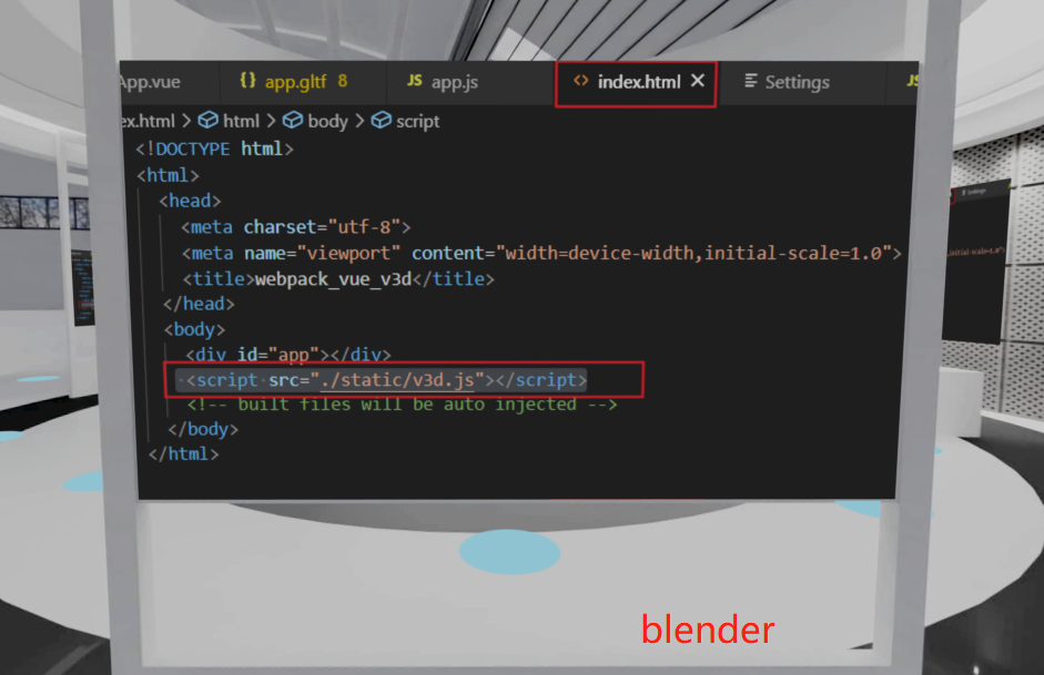

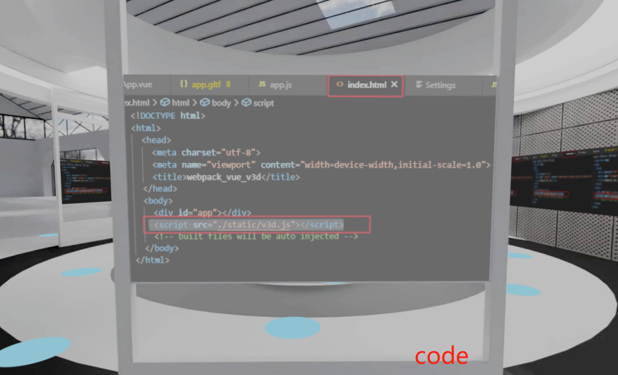

    Hello, due to the project reasons, some places have to use code to write, when I use code to add a map to the model, the effect of the map display is different from the map in Blender, what is the reason?

    MeshBasicMaterial is not affected by light and Blender Materials by default are. So there will be a drastic difference between the two.
    https://threejsfundamentals.org/threejs/lessons/threejs-materials.html
    If you are wanting the blender result via code, you will need to add a bit of complexity to your code to layer up a material. Black background, alpha masked text color and then add emissive properties to the color. Depending on how glossy you want the screen you may need to change the baseMeshMaterial to another material form to get the desired effect. BaseMeshMaterial is 100% flat so it looks more cartoon like and I believe would not match the your background scene.

    Thank you very much for your reply, because my problem is not described in the order, maybe your answer is different from what I want, I also use Emission in Blender.
    But I’ve solved that problem, just add this code to add the following code when loading the text.
    texture.encoding = v3d.sRGBEncoding;
    Here is a complete code。
