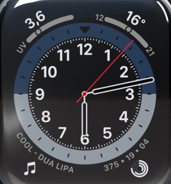

    I must realize a clock, but for see the hours turned.
    I’m accelerating the watch pointer movement. The pointer : minute at 360° withe 200 frames. The mouvement is repeat in Verge 3D setting / Auto start once / repeat / infinitely.
    For the hours : at 200 frames the angle is 30° (1 hour). I use the setting CHANEL : Extrapolation Mode / linear.
    There is modifier too but I can understand the difference.
    The browser Verge 3D don’t work for the hour, after 30° it’s stop it. Why ? In Blender it’s work.

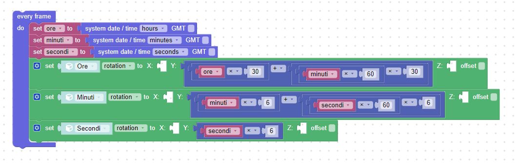

    #7466
    Extrapolation mode does not supported, so when animation ended it’s sopped. It will depend on how you made all the scene I can give you a solution, but I think procedural (without animation) rotation would be better choice to make a clock.

    #7470
    Rotation is a animation, isn’t it ?
    Instead of animation you can use Set Rotation puzzle and rotate your pointers each second, 60 seond etc.

    #7475
    It’ easy, here’s an example for you.

    hi i created a clock, hours / minutes / seconds
    it works fine, but the hour hand only moves when the time strikes, your watch works better, can you help me.
