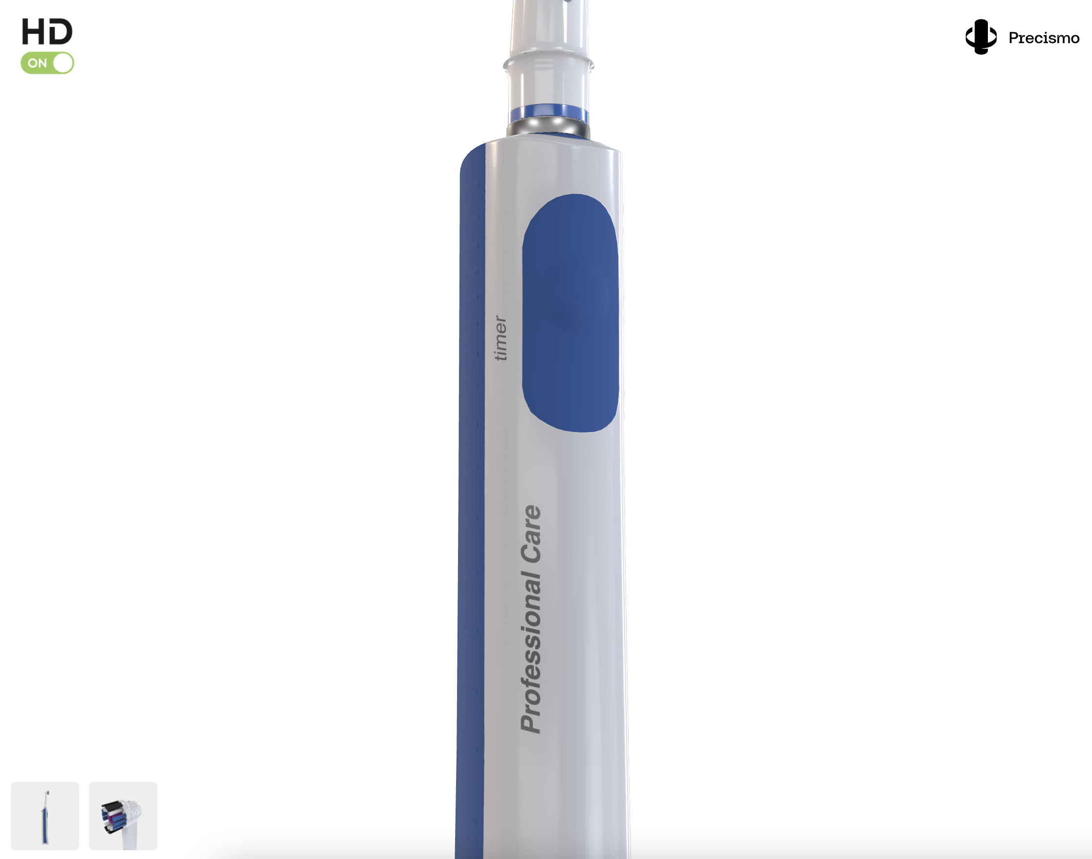

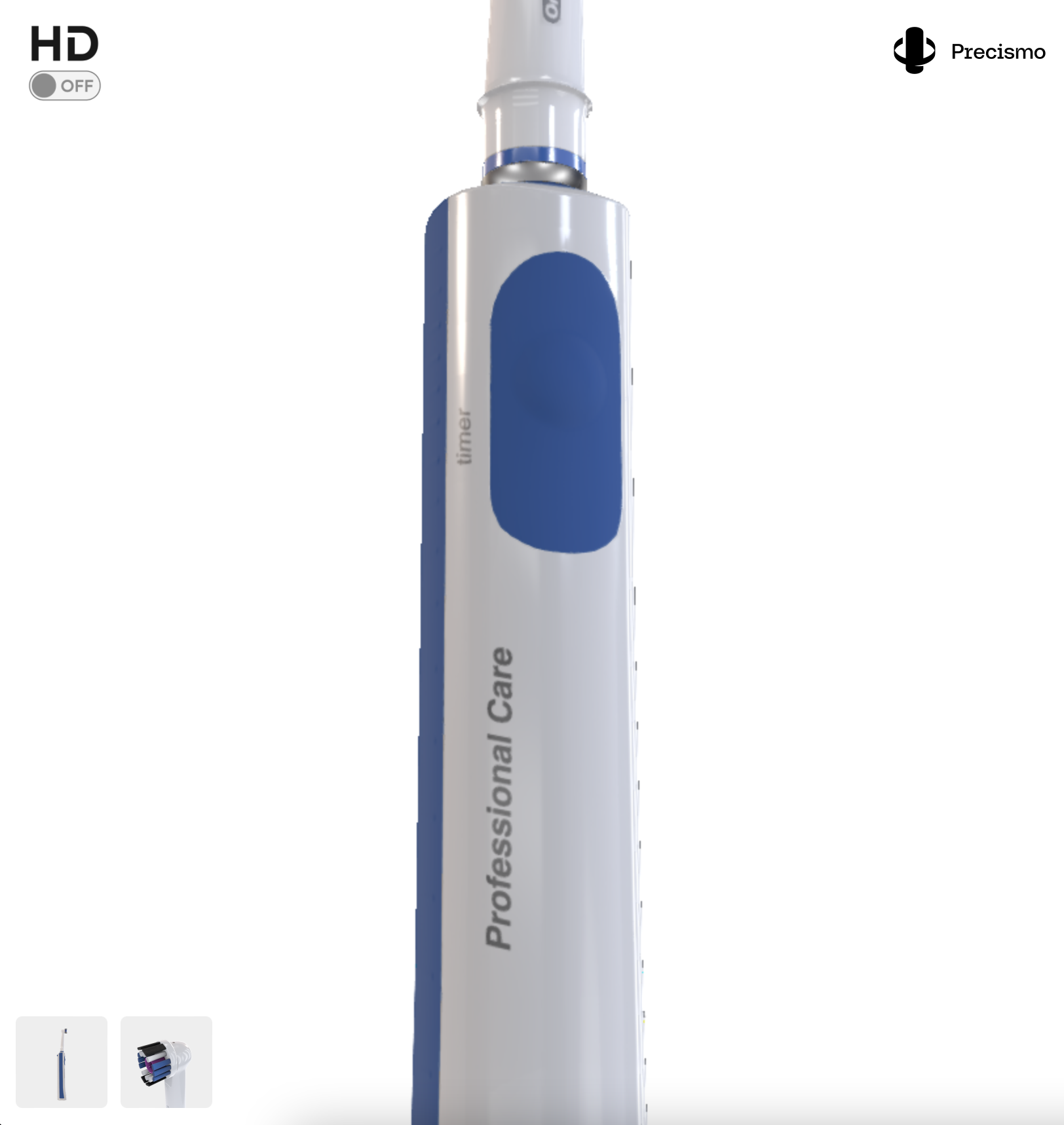

    we have noticed that latest Safari 12.3.1 is somehow rendering pictures in lower resolution, making it uglier/aliased – attached are rendeders from same scene rendered in Edge and Safari on MacOS.
    – Problem seems to be Browser issue (Edge works well) and engine-independent.
    – Browser is reporting same values for window.devicePixelRatio (2) for both working older version and new 12.3.1
    – We have tried following workaround with setting setPixelRatio but it does not seem to have desired effect (way up to draining 3.0 is still noticably aliased)

    Our customers are complaining about picture quality. Please can we report this to Apple and/or have some workaround this? :good:

    in one case HD is off… maybe, they should click on that button to turn HD on? or is it inactive and unclickable? btw, what version of Verge3D is used? for example, 3.9.1 reduces screenscale on my iPhone and the result picture looks really ugly ))) 3.9.0 (and lower) dosn’t do this

    Hi, yes, we have “quality button” we have implemented ourselves but does not work on Safari+IOS. It uses mentioned code.
