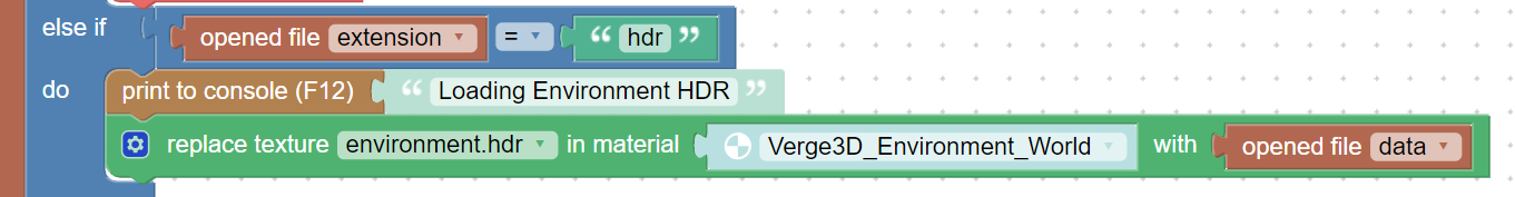

    I’m attempting to implement a feature where users can drop an .hdr file onto the page, and the scene’s HDR will be replaced with it. I already have a working file drop system; when users drop a .glb file, the scene loads at runtime.
    However, the logic for replacing the scene’s environment HDR doesn’t seem to work, as nothing happens after dropping the HDR file.
    Are there any limitations to this, or am I doing something wrong?
    #71572
    The extention can be HDR and in this case the condition won’t be met.
    #71588
    rodrigogama
    I added the print statement just to make sure the condition was met, and it printed successfully when I dragged an HDR file.
