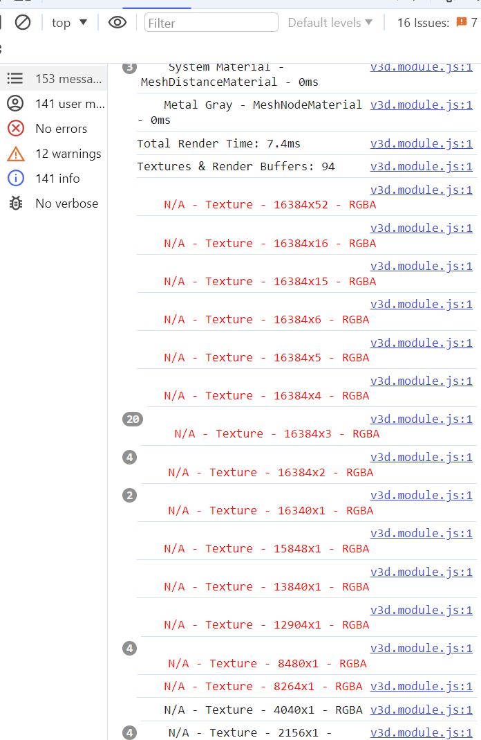

    @stellar it might be due to large shapekey textures:
    #74608
    stellar
    Im sorry, but I dont know what shapekey textures are. I can’t pinpoint the location of those textures either in my v3d app and blender files. Do you know where do i find those?
    #74609
    studiogijs
    @stellar, you can’t, those are generated automatically and are used by your graphics card to displace the mesh. But the more points you have in the mesh, the larger this texture becomes.
