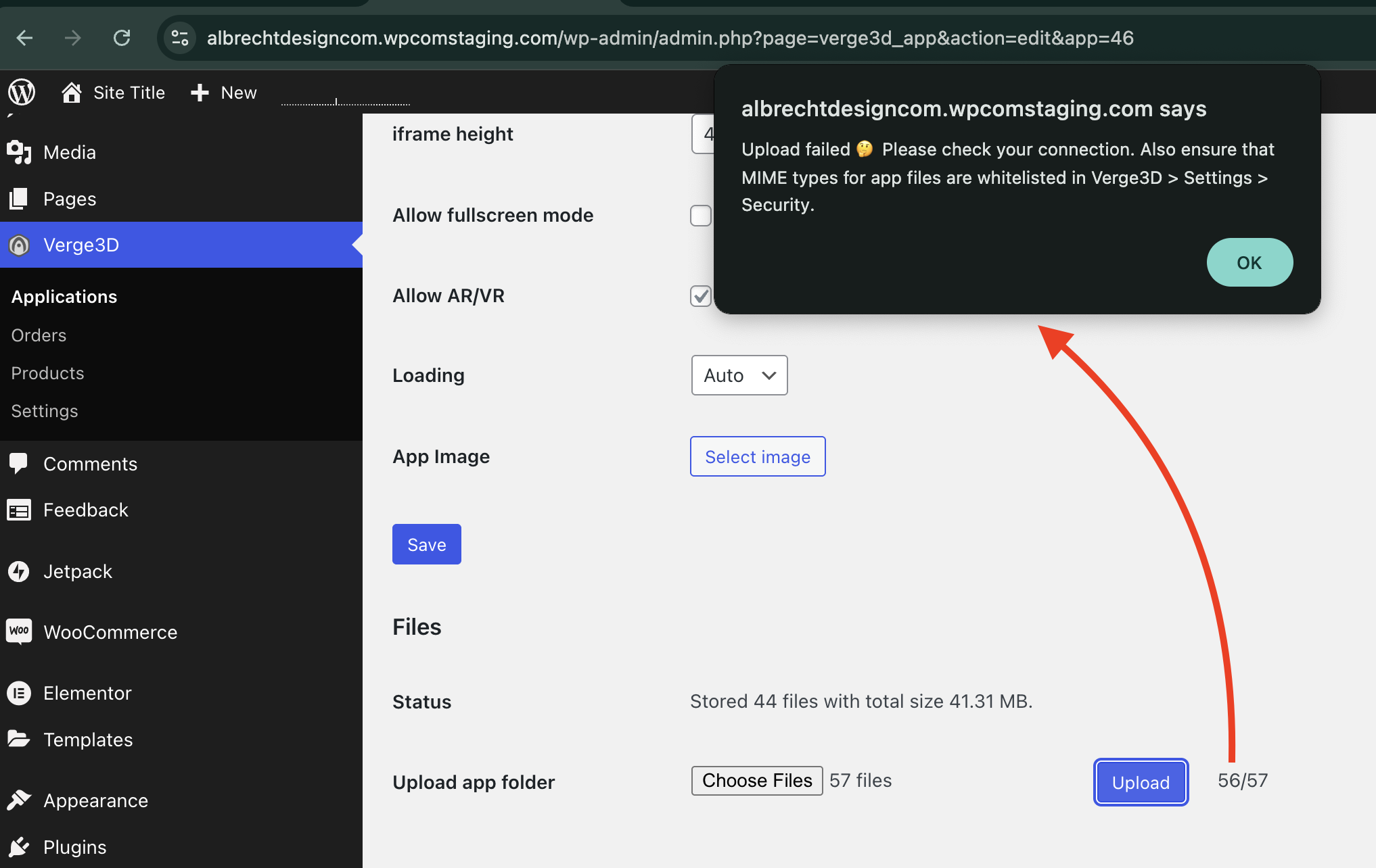

I have followed the example and in the Additional CSS class(es) I added the class my-button, then in the query selector I entered my-button a as the instructions and that does not work. It can’t find that element.On another note, have been getting an error when uploading the Verge project (files) using the plugin. You can see the screenshot attached. I appreciate your guidance / comments on that. Thanks

document.querySelector(" ... ")right in the browser console.Regarding the upload fail, apparently there is one file that has invalid MIME type (extension). You might need to review your app folder to find it and add its MIME to the plugin settings.

The issue with the files upload was related to the application/x-apple-ds-store ds_store hidden file.
On a Mac, the mime type for a “.DS_Store” file is typically not officially defined, as it’s a system file used by the Finder to store metadata about a folder’s appearance (like icon positions and view options), and is considered a hidden file, meaning it doesn’t usually have a designated mime type; however, some systems might identify it as “application/x-apple-ds-store” if needed to handle it specifically.Thanks
