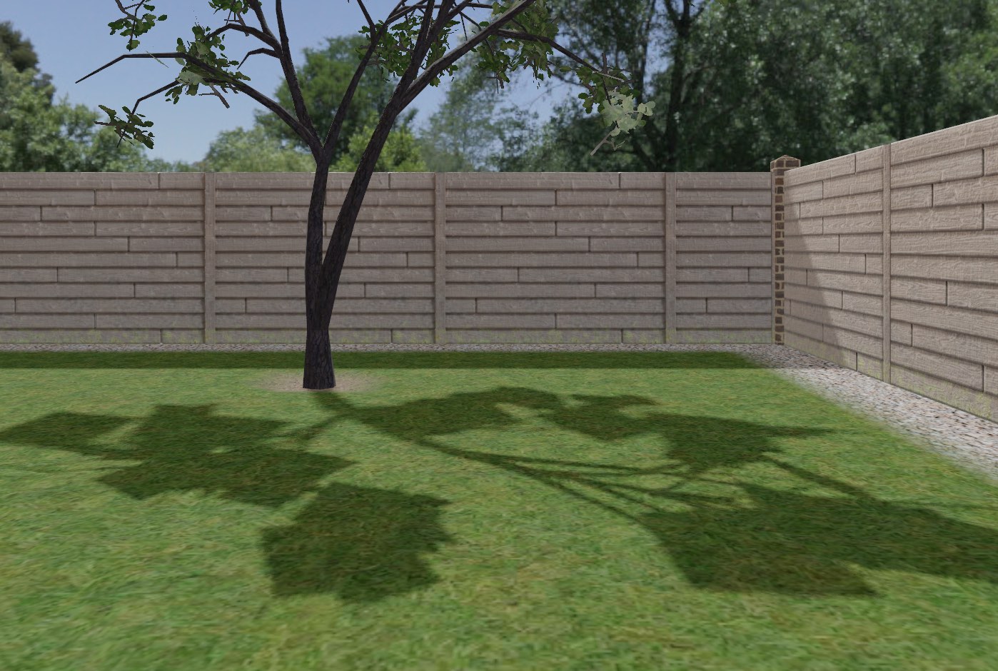

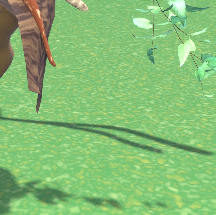

    I believe verge3d could generate alpha clipped shadows for plane object with alpha clip textures before version4.3. Now you can get only polygon shaped shadows.
    I think this is a serious bug for high quality visuals.
