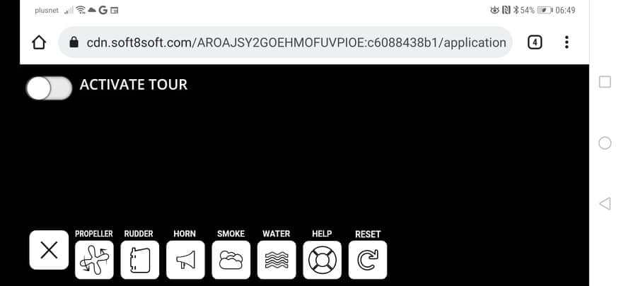

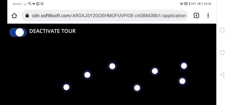

    The message I am getting is that the iframe is black, but that overlays such as annotations are showing.

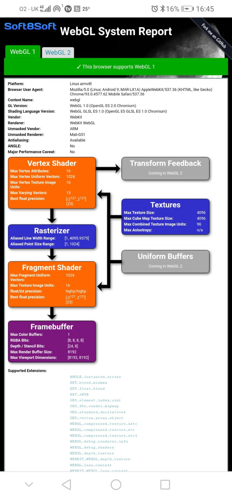

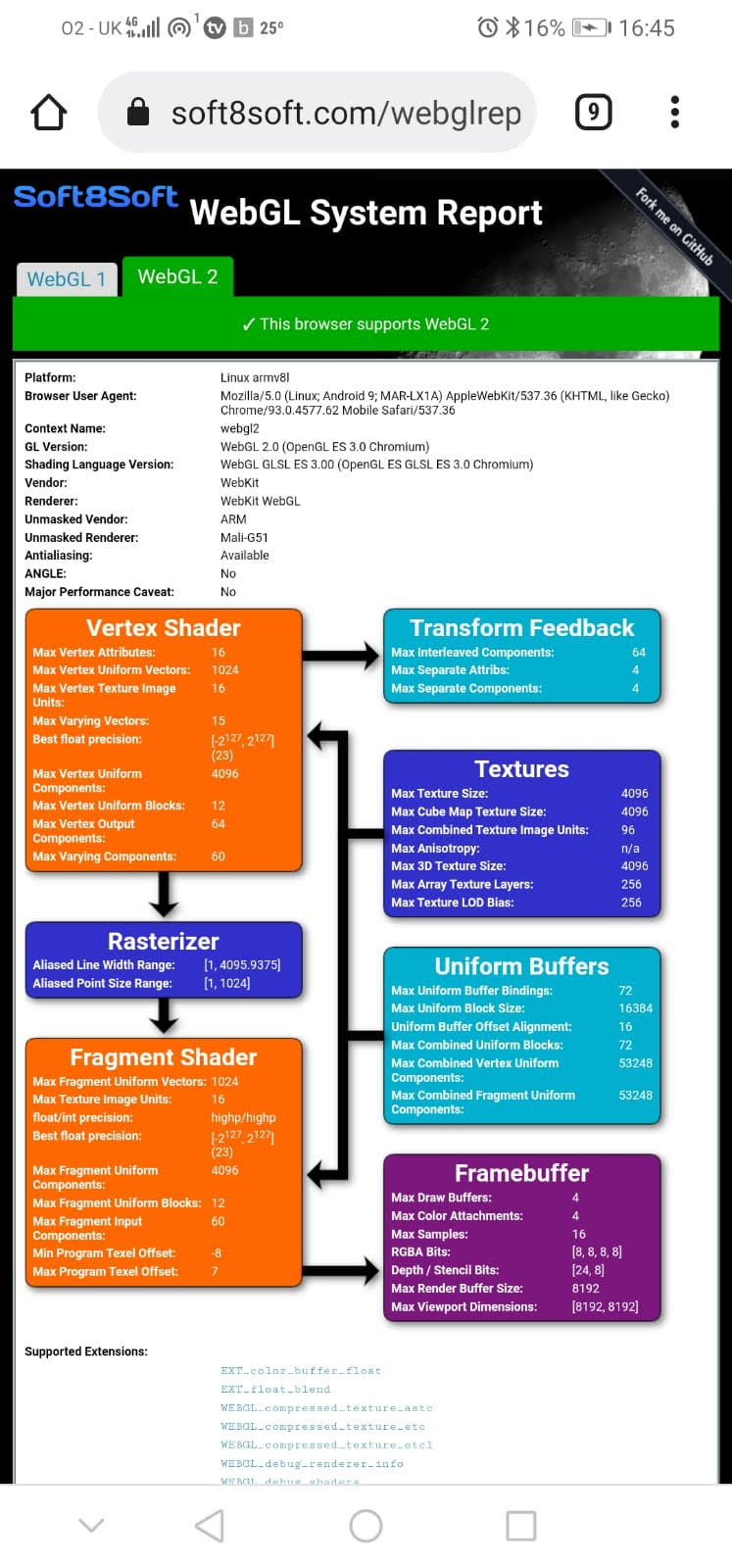

    jdhutchinson
    Dear Alex,
    See attached files. My customers phone is Huawei p30 lite.
    ANy suggestions on why it might not be working for him?

    #45234
    We’ve checked your application on the Huawei phone (browser version is 11.1.3.310) and it works just fine. I believe this issue might be connected with insufficient memory or so (your app is a bit heavy for slower and older mobiles). Please provide more info on the phone model so can say further.
