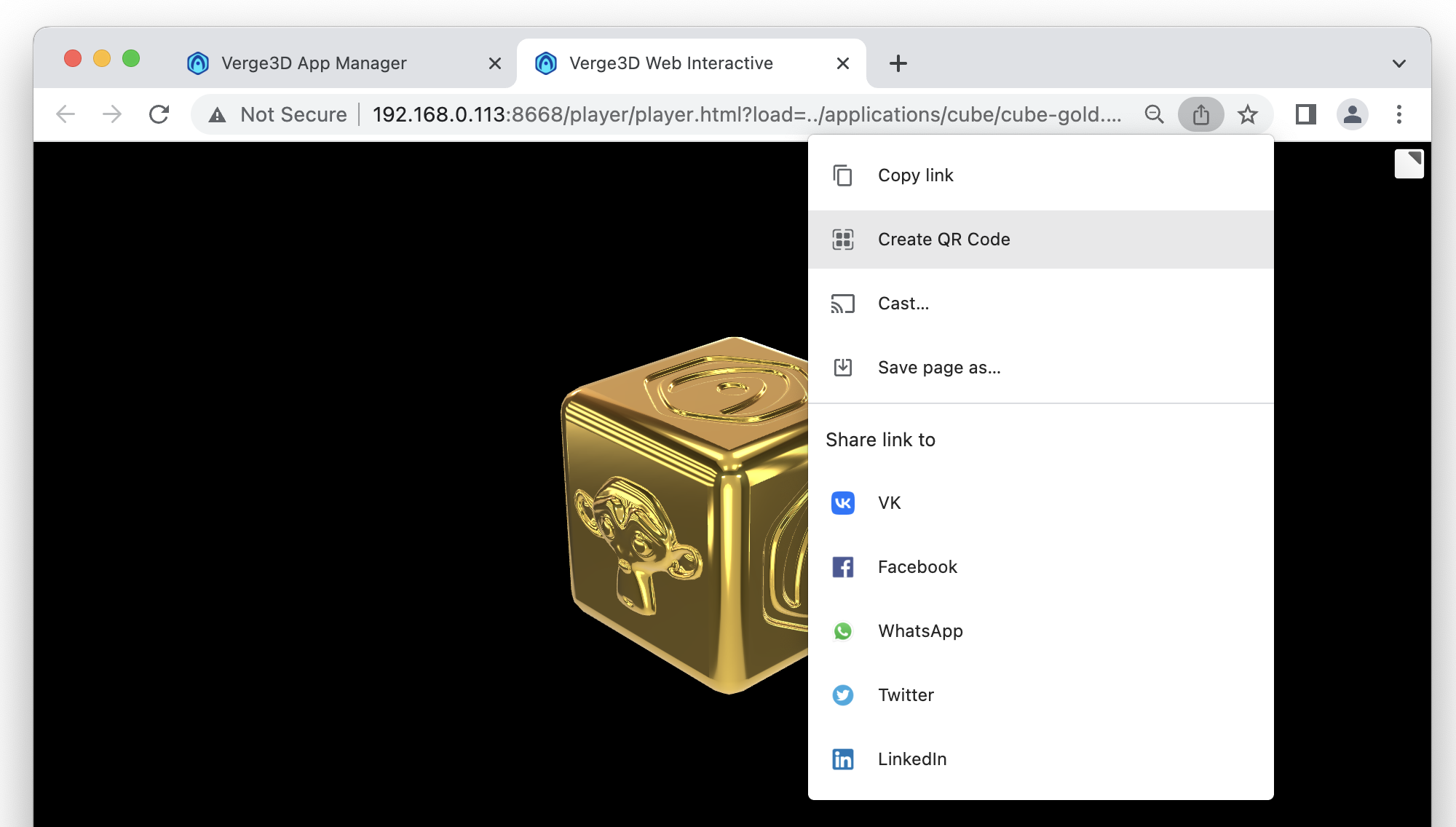

A link to the application can be conveniently opened on mobile using a QR code. To generate such QR codes, use the sharing feature of the Google Chrome browser (also available in Microsoft Edge):
Generating QR codes in Chrome browser
For other browsers you should use QR generator extensions for the same purpose.
The obtained QR code can be scanned with a mobile device's camera (by using the built-in camera app) thus opening the link on a mobile browser.

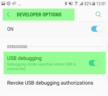

On an Android device, go to Settings → Developer options and enable USB debugging.
By default, the developer options in Android devices are hidden. You can unlock them by locating the Build number in your Settings menu and tapping it multiple times.

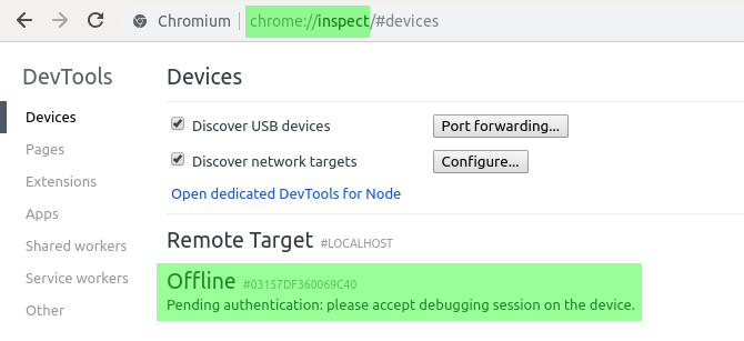

Connect your Android device with a USB cable. In Chrome browser on your computer, navigate to chrome://inspect.
Chrome Inspect page

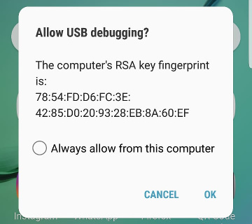

This should show a dialog popup on your Android device - if not, reload the chrome://inspect or re-insert the USB cable. In the popup, allow USB debugging by tapping OK.
Allow USB debugging popup dialog
You now should see your Android device on the chrome://inspect page. Also, if you open Chrome on your mobile device, it should be listed there.

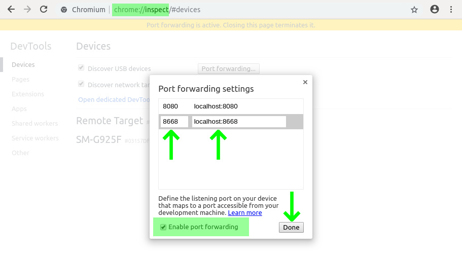

Click Port forwarding button on the chrome://inspect page. In the shown-up window fill the Port and IP address and port fields as follows:
Verge3D flavor Port IP address and port
Verge3D for Blender 8668 localhost:8668
Verge3D for 3ds Max 8669 localhost:8669
Verge3D for Maya 8670 localhost:8670
Verge3D Ultimate 8668 localhost:8668
Enabling port forwarding in Chrome
Check Enable port forwarding and close the window with Done button.

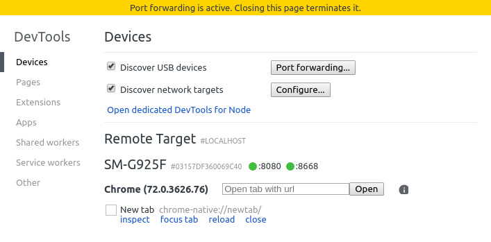

The chrome://inspect page should display a green indicator for port forwarding near the device.
Testing port forwarding in Chrome
As a result, you should be able to launch the App Manager right from your mobile device's browser by navigating to localhost:8668. In addition, you can see the output of the mobile browser's console by clicking inspect link on the chrome://inspect page.
