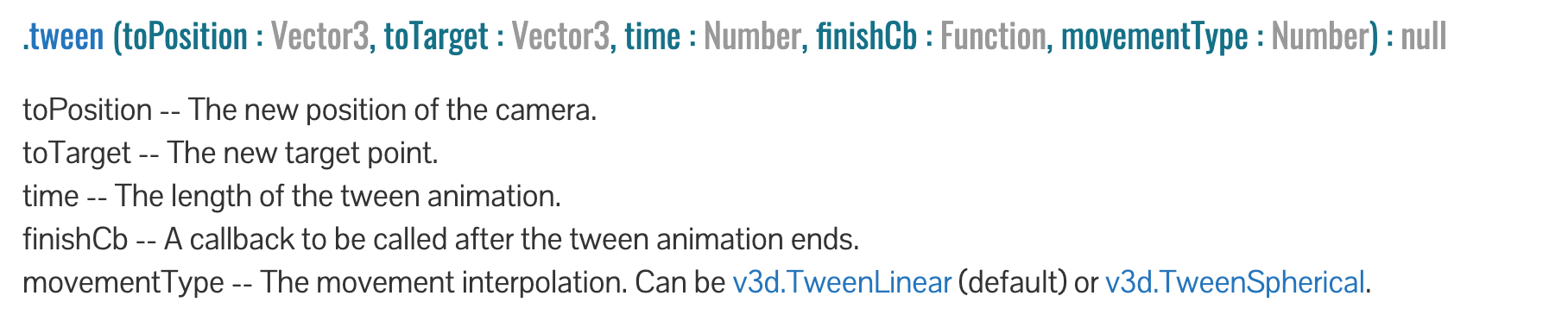

ParticipantHi,
As you can see the screenshot i attached, in the document it shows that i need to get vector3 value for tweening.
Unfortunately, I’m not familiar with the scalar value.😢
{x: number, y: number, z: number} <- Is that scalar value?

Ivan LyubovnikovStaffHi,
You might find this method useful: Vector3.setFromSphericalCoords(radius, phi, theta), where phi is the polar angle and theta is aziumthal.
2020-12-01 at 5:03 am #36116eatdesignlove
ParticipantThank to you i figured it out!
const vector3 = new v3d.Vector3();
const position = vector3.setFromSphericalCoords(
distance,
controls.getPolarAngle(),
controls.getAzimuthalAngle()
