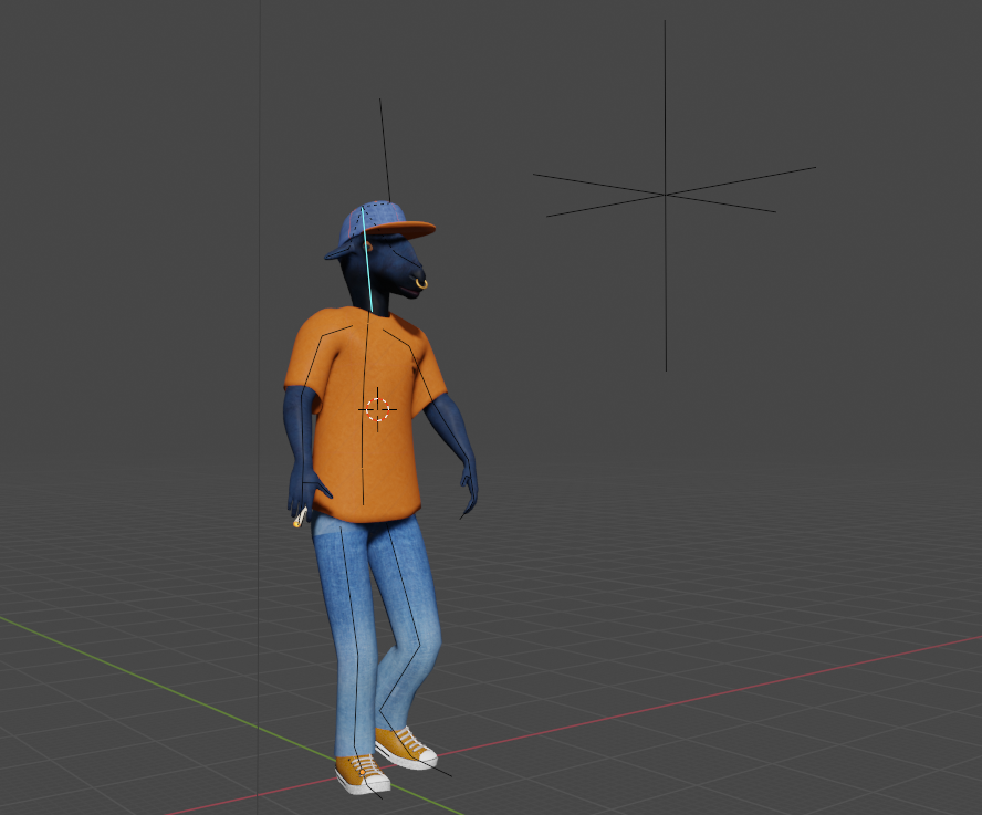

I create in blender 3d character walking animation in a loop. the “headbone” of this amature (there is no keyframe to this bone) I connect to Cross with bone constraint – track to.
in blender when the walk animation working, I can take the cross and move around, the head follow the rotation after the cross.now, in Verge3D, I want to move the head to side by move the cross after the mouse pointer around, how can I do it?

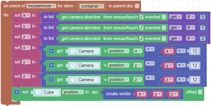

2022-12-26 at 2:48 am #59234kdv
ParticipantYou already have the solution https://www.soft8soft.com/topic/camera-problem-with-puzzles/ in your own topic.
Just uncheck “inverted” and increase the factor from 3 to 10+. This factor defines the distance between the scene camera and your object.

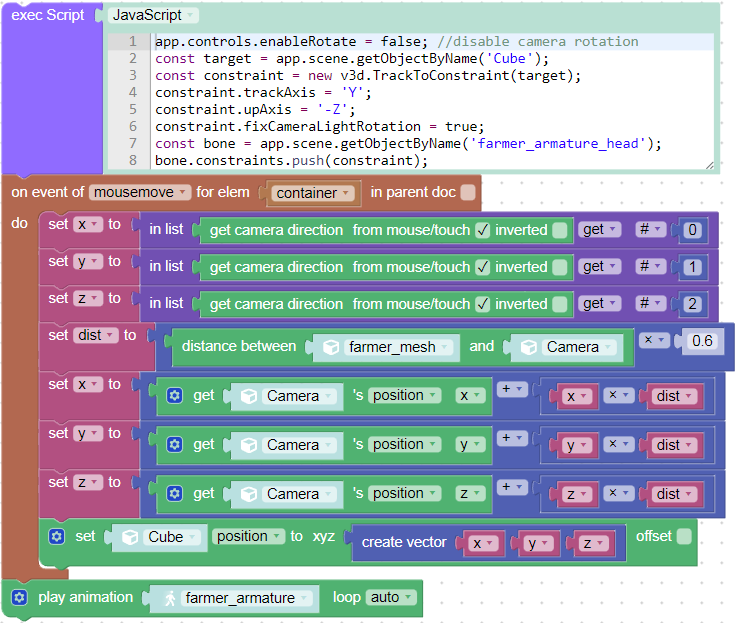

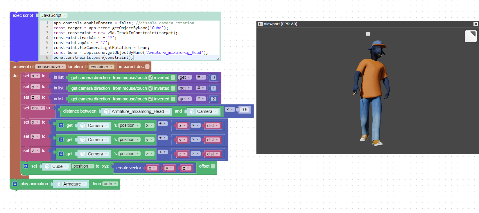

2022-12-26 at 10:11 pm #59251liranhersh
ParticipantI did the same code like in the picture I add.
no working. but when I delete the exec script, the cube following well after the mousemovement/what is the problem with the java script?
app.controls.enableRotate = false; //disable camera rotation
const target = app.scene.getObjectByName(‘Cube’);
const constraint = new v3d.TrackToConstraint(target);
constraint.trackAxis = ‘Y’;
constraint.upAxis = ‘Z’;
constraint.fixCameraLightRotation = true;
const bone = app.scene.getObjectByName(‘Armature_mixamorig_Head’);
bone.constraints.push(constraint);Attachments:

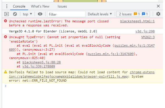

2022-12-27 at 5:35 am #59253kdv
Participantpress F12 and see errors in the browser console. your code is working (one typo: constraint.upAxis = ‘-Z‘;). problems can be with the target or bone objects. see the log which of them is undefined.
p.s. share your app files or blend file.
2022-12-27 at 1:45 pm #59263liranhersh
ParticipantTNX :)
WHAT IT MEAN THE PROBLEMS, I DONT UNDERSTAND, WHAT I NEED TO CHANGE IN THE SCRIPT CODE?Attachments:
2022-12-27 at 2:59 pm #59265kdv
Participantremove the first line in the script. Looks like you use camera with no controls or it’s not the orbit camera and there is no need to disable the camera rotation. red error warnings are in English and they can be read and analyzed )))

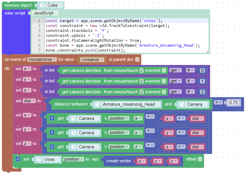

2022-12-27 at 4:20 pm #59267kdv
Participantsee no problems with your sheep. it works as expected with no additional actions from my side…
const target = app.scene.getObjectByName('cross'); const constraint = new v3d.TrackToConstraint(target); constraint.trackAxis = 'Y'; constraint.upAxis = '-Z'; constraint.fixCameraLightRotation = true; const bone = app.scene.getObjectByName('Armature_mixamorig_Head'); bone.constraints.push(constraint);Puzzles and JS coding. Fast and expensive.
