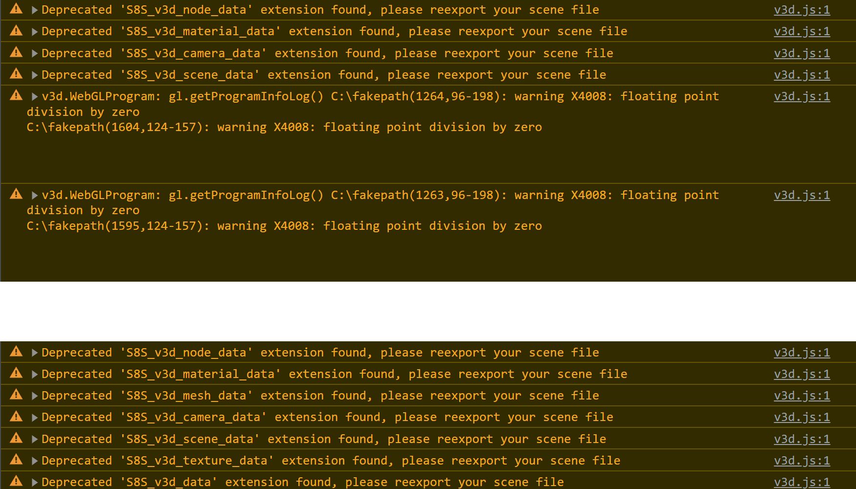

    I have a configurator that I never would have been able to do without Verge (thanks!) and it has been working great until my upgrade from 4.1 to 4.3 and now getting tons of deprecation errors and super slow load times. (10secs vs 2).
    I think I followed the instructions of the 4.0 migration guide properly, and re-exported the primary scene (room) and several product sub components (as gltfs loaded from html – I have >100 glft files for product sub components).
    Anyway, do the below errors give any hint where the problem might be?
    With thanks!
    ps. errors and slow load are in all browsers/ and iOS, but not Android which loads a complex product (12 gltfs) in <3secs. Also, all materials are external to the app.

    Still get the deprecation alerts though,
    That’s because your app is still using old gltf/bin. Maybe you re-exported your files somewhere but your app sees only old files…
    One more possible reason: you didn’t update Verge3D add-on and it exports with old extensions.

    thanks for the quick reply and suggestion kdv.
    I double checked and the re-exports are being ftp’d to the correct server folder, and I run the browser with Disable Cache checked.
    I also deleted the primary gltf and bin off of the server, refreshed the page to make sure I got a 404 file not found, then re-uploaded the new files and refreshed with same deprecation errors.
    , so pretty sure it should only be seeing the new gltf/bins.
