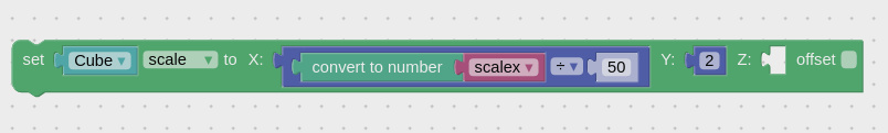

    Got it – you have to convert your scale factor to number first as value is textual:
    BTW print to console is a very useful puzzle with which you can check if events are fired, and what values are generated in the script.

    Great !
    I could have found this by myself.
    Many thanks !! :)
