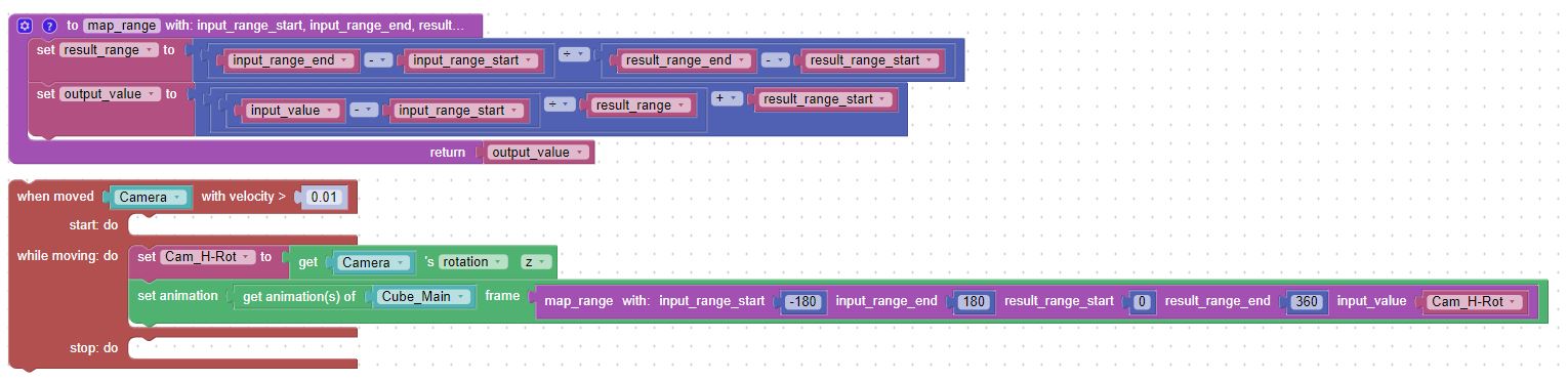

    In Blender 2.9 i can set the min/max angle of the cameras horizontal rotation, which is great.
    now i would like to get the current camera rotation value in puzzles to drive an animation with it.
    so if the user orbits around a object, the object animates accordingly. i looked at your beautiful swiss army knife scroll example to get inspired, but that uses html scroll to drive the animation…
    any tip?
    EDIT: I just found the get object’s rotation x node. sounds promising
    now the question remains, which is the overall event that i should use?
    on event of mousedown/mousemove?
    The image shows my current (not yet working) progress

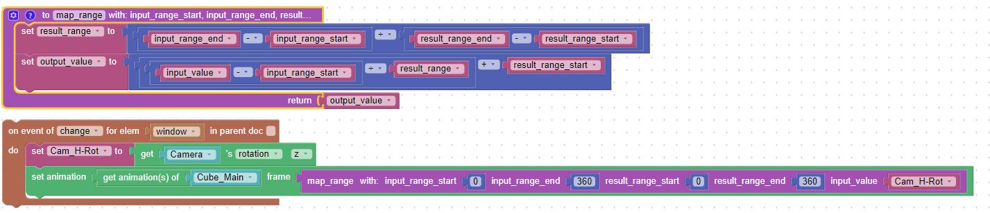

    got it to work :)
