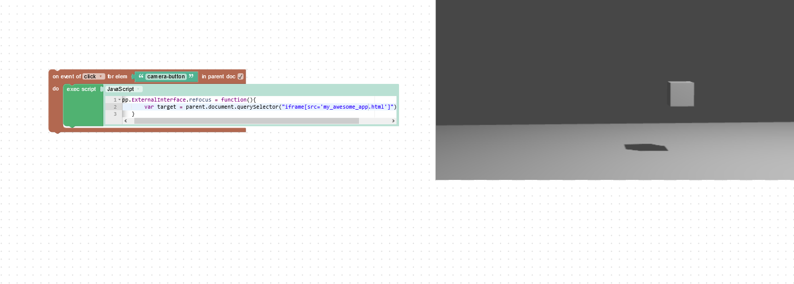

CustomerEhy guys, I implemented the snippet on a pressed interface button but focus of keyboard doesn’t work. Just the mouse.
dunno how to do, can you help me somehow?

here the link. It’s as simple as possible, i made this just to understand this bug.https://cdn.soft8soft.com/AROAJSY2GOEHMOFUVPIOE:eefbc26a42/applications/my_awesome_app/index.html
i put here the whole application and a screenshot, hope you can help me :D

Customeri did it, check the puzzle, doesn’t work anyway
i put the name of my app.html, in that case my_awesome_app.html, assuming the your_app.html of the snippet was generic. correct?

Yuri KovelenovStaffthat’s strange, because the scenario in the linked app still refers to
your_app.html

Customermaybe i changed it later for mistake. Now in visual_logic.js is my_awesome_app, but still not working.

Yuri KovelenovStaffI see. This is because such the configuration just registers the function but does not execute it. It worked for me after I placed the only exec script puzzle in the main Puzzles tab with the following line in it:
parent.document.querySelector("iframe[src='my_awesome_app.html']").focus(); -
