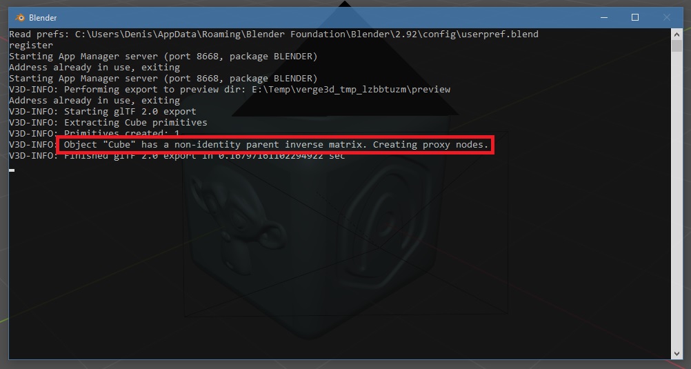

    Your object must be a direct child of the camera. If not you will see the error message on the browser’s console (F12).
    In blender click Window -> Toggle system console and see the log after exporting.
    Non-direct child, with a parent inverse matrix
