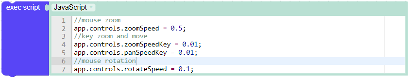

    Hej!
    I would like to change the Rotation Speed and Movement Speed on the camera, without the need of exporting the scene.
    Depending on the device and the situation in the scene, I want to dynamically change the values.
    Is that possible within Puzzles? Or maybe with some custom code blocks?
    Thanks for your help and best regards!

    #52535
    #52539
    That works. Great and quick answer. Thanks!

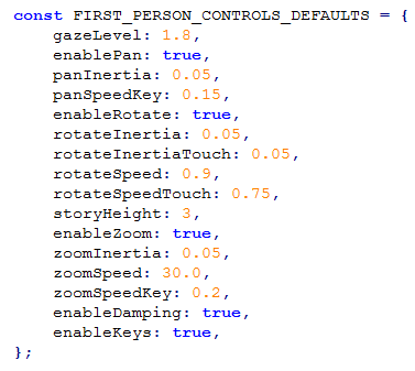

    #52556
    Is there a documentation available where I can find these and possibly all other constants which are available and configurable via puzzles in verge3d? Or is this constant from an underlying library, maybe three.js? Where could I search when I have similar questions again? :scratch:

    #52560
    I don’t know :unsure: I found those constants in unobfuscated v3d.js using keywords like “zoom”, “pan”, “rotate”, “control” etc.
