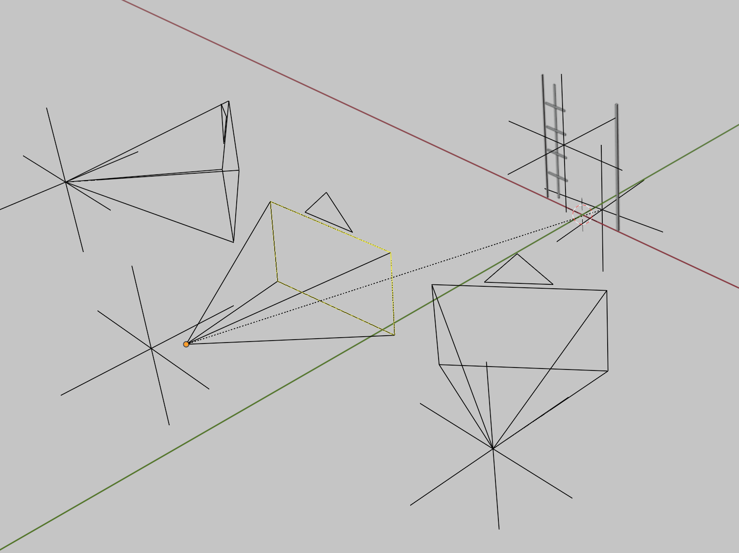

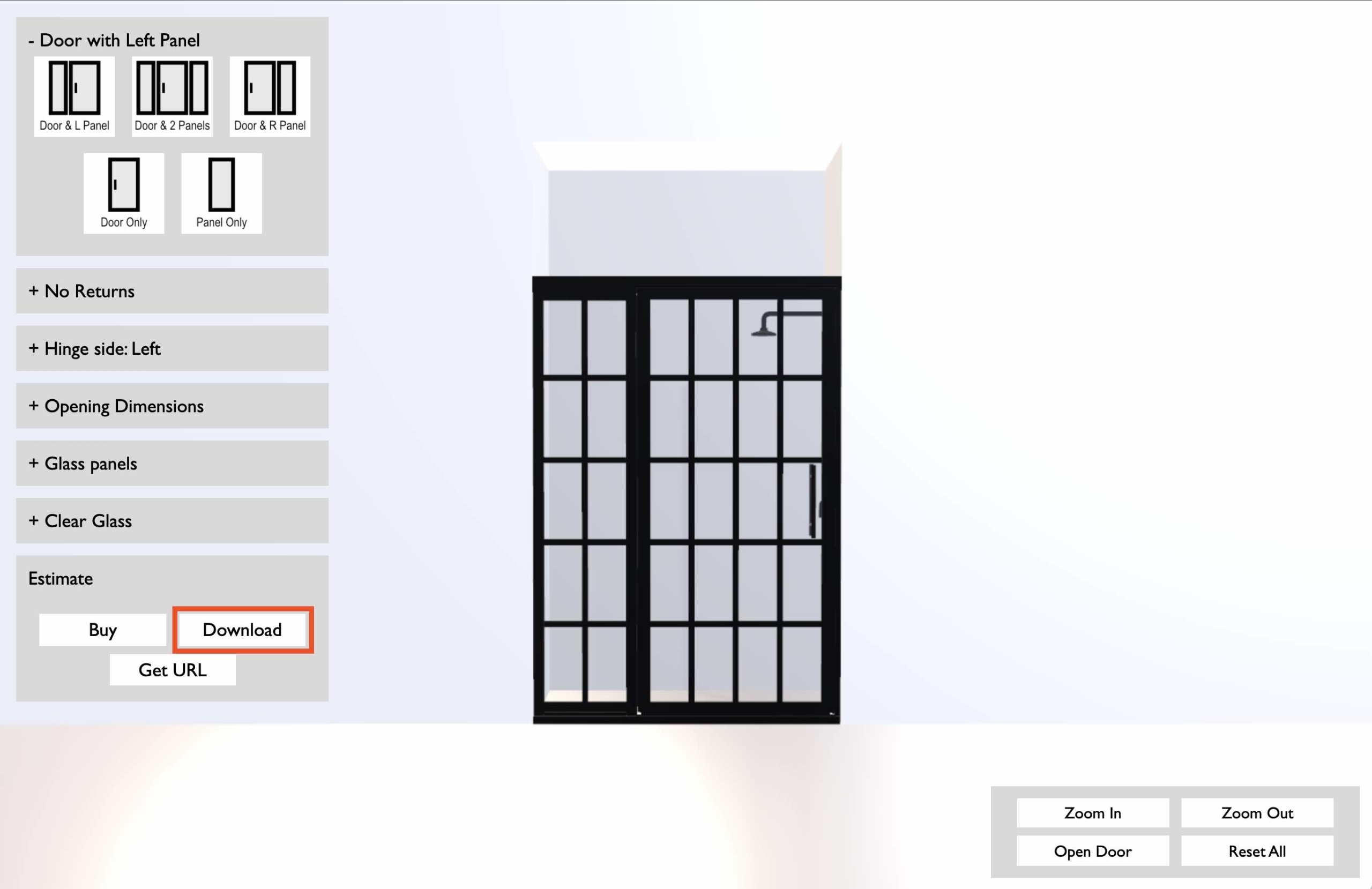

CustomerOpen up the app, wait a couple of seconds for it to load, then click on the Download button (first attachment). The ‘gridscape.gltf’ file downloads as expected. Open the file and be disappointed by what you see (second attachement), or more importantly, what you don’t see.

Yuri KovelenovStaff2020-11-07 at 1:12 pm #35114johngrigni
CustomerBlender 2.90
2020-11-07 at 1:15 pm #35115johngrigni
CustomerBlender 2.83 gives the same results, as does this website: https://gltf.insimo.com/
